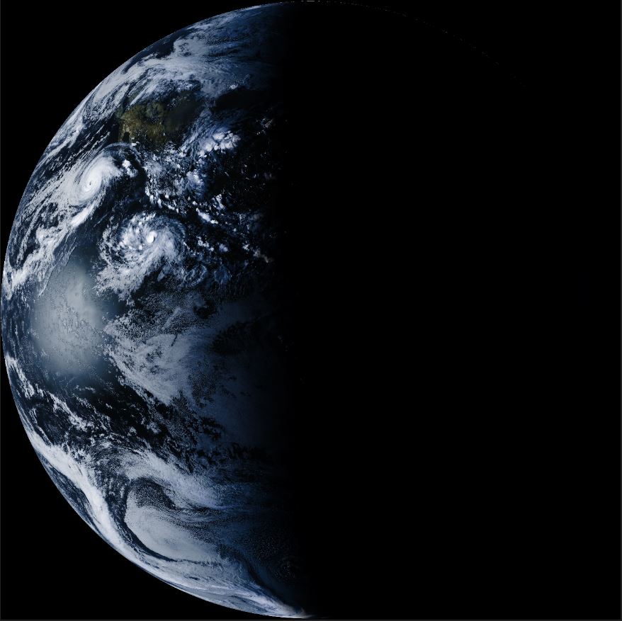

GOES 16 image from today (January 27, 2018) colorized with Adobe Photoshop. The USA-Satom XRIT decoding software is now operable with both the RSP1A and the RSP2.

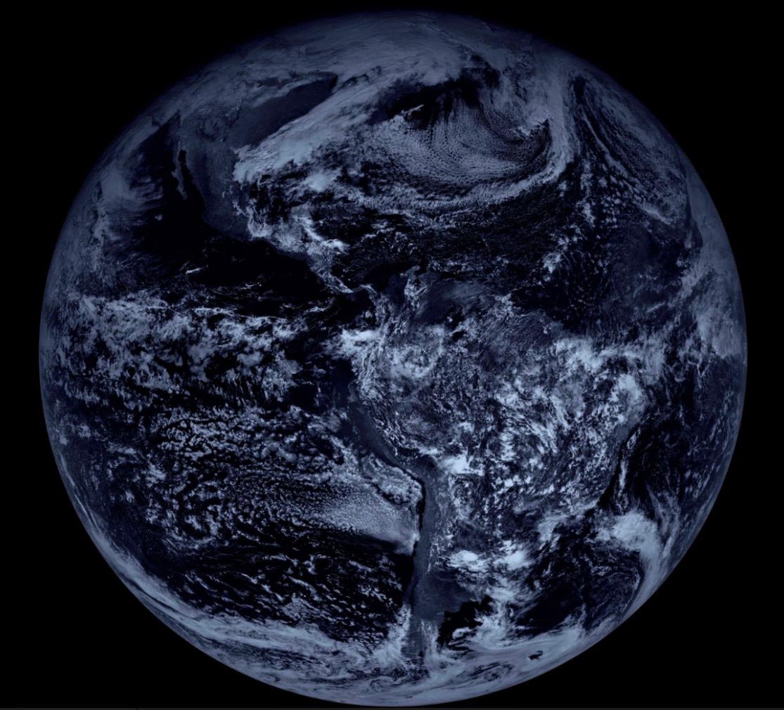

A nice full Earth GOES 16 HRIT image from today - February 4, 2018.

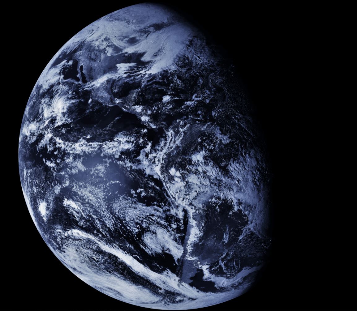

USA-Satcom has just released v2.1.0.0 of the XRIT Decoder. Along with enhancements for the XRIT Decoder, a new RSP Streamer X has been released and is operable with the RSP1A, RSP2, and RSPduo - new features include operation with two streams simultaneously (provided that the PC being used has sufficient processing power and an RSPduo or more than one compatible RSP are being used). Also new is the XRIT File manager which allows for improved operation with both LRIT and HRIT files, improved LUT for excellent false color images, user-selectable automated black filling of the white background on full disk visual and false color HRIT images, and country as well as state map overlays.
The new color enhancements are excellent:

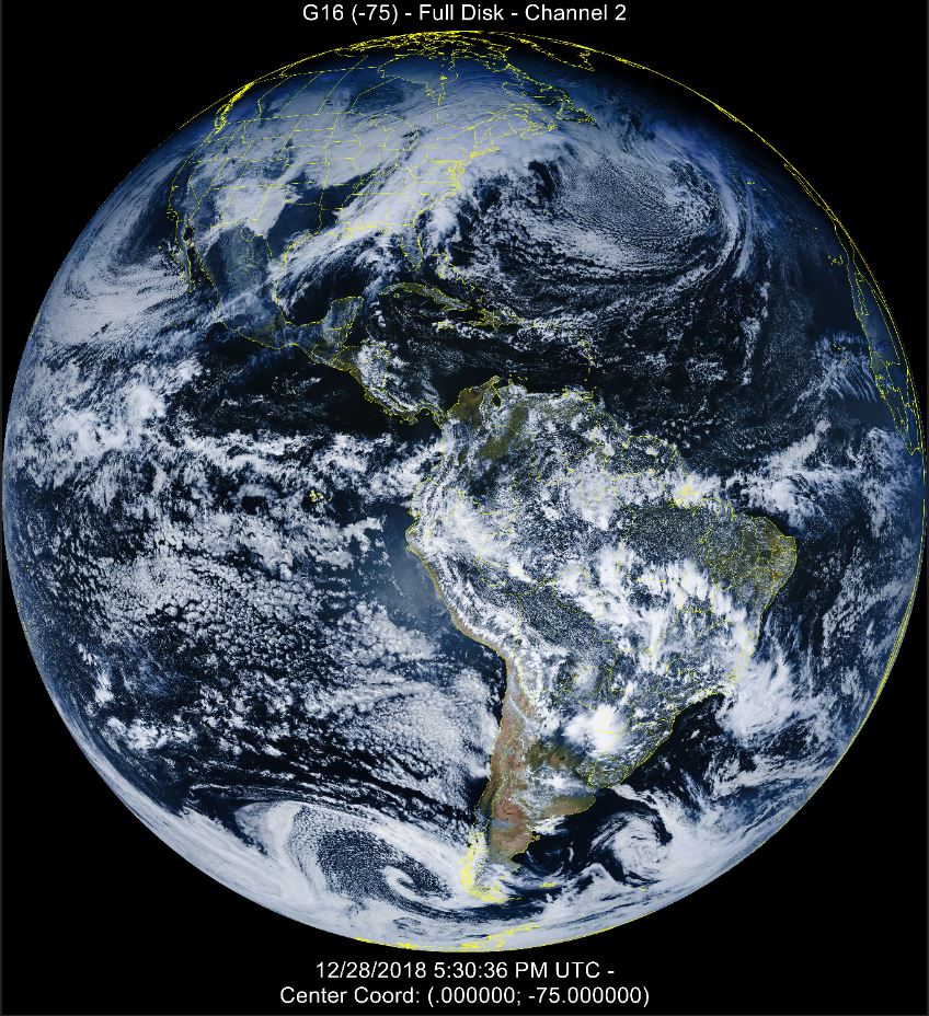

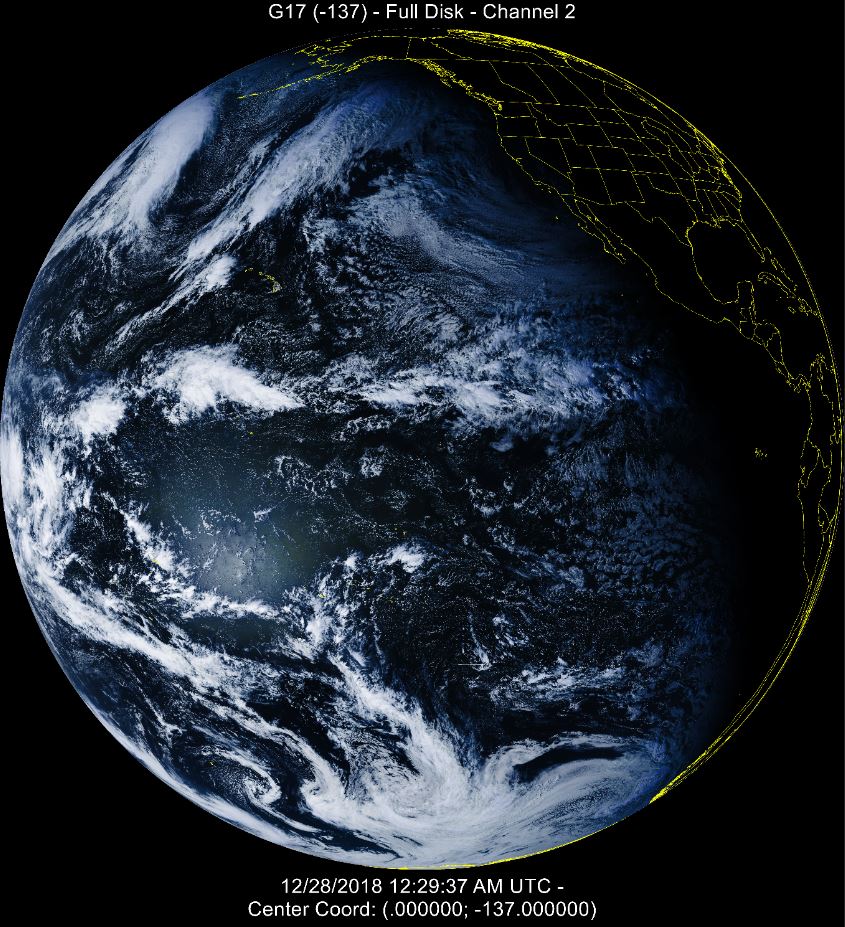

Post by RSP2user » Fri Dec 28, 2018 6:03 pm
USA-Satcom has continued improvement efforts on RSP Streamer X, the XRIT Demodulator, XRIT Ingestor, and now added an XRIT File Manager. New features include mapping overlays, improved file management, and improved false automated color capabilities. The software is operable with GOES 15, GOES 16, and GOES 17 satellites in the United States. Contact USA-Satcom for operability with other satellites. GOES 17 is not officially in full service yet.
