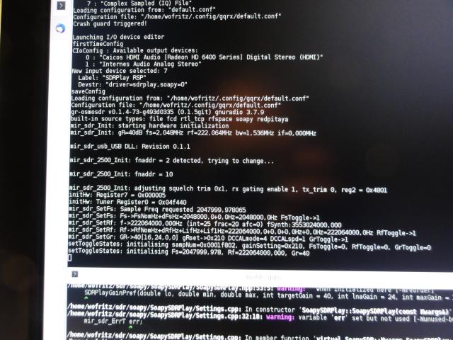

Hello,
today I installed the new Kubuntu 16.04.
I installed the SDRplay API and rebuilt all my libraries and qgrx from source.
When I start gqrx, it finds the sdrPlay but during initialization the laptop locks hard, I have to press the power button for >5 seconds to recover.
Cubicsdr gives same result.
Anyone had success with Kubuntu/Ubuntu 16.04 and sdrplay?
Attached is a screen shot of gqrx start up up to the freeze.
Regards,
Wolf, DK7OB

Re: sdrplay with Kubuntu 16.04
Some here, with Ubuntu 16.04/64 bit, after upgrading from Ubuntu 15.10
SoapySDRUtil is correctly working.
CubicSDR is starting, find SDRPlay device but, after starting it, my PC is locked and I have 2 flashing leds on my keyboard.
Only power off or reset is able to recovery.
In 15.10 all was correctly working.
And a RTL-SDR device is working without problem with CubicSDR.
I suppose there is something in API in contrast with Ubuntu 16.04 and/or new kernel
For now my advise is to not upgrade to 16.04 until SDRPlay support correct this problem
Regards
Franco Spinelli
Thanks Franco for your reply.
Now I know it's not my own fault. I hope sdrplay support is able to look into it soon. Fortunately I kept my working 14.04 installation.
Since there were a number of Ubuntu package updates, I tested again today.
Result:
SDRPlay is working with the USB ports marked "SS" (I think this means USB 3.0) on my Laptop. On the "normal" USB ports the Laptop still locks hard.
I *think* I checked all USB ports during my first tests, but I'm not sure, so I don't know if the updates changed behavior or the ports were working before already.
I will re-test this evening
My last test is at 3 of May, without any improvement.
I am using same USB port as in Ubuntu 14.04
And in Ubuntu 14.04 CubicSDR is working without any problem.
On my desktop PC I don't have USB 3 port, so I can't reply your test.
Done another test after updating Ubuntu 16.04
Changed 2 USB port (one is port used for SDRPlay with Ubuntu 14.03, the other is a frontal USB port)
Non change. At startup of SDRPlay, after initial choice of device in CubicSDR, Ubuntu crash with 2 keyboard led flashing.
CubicSDR is correctly working with a RTL-SDR dongle.
Any help from SDRPlay support?
