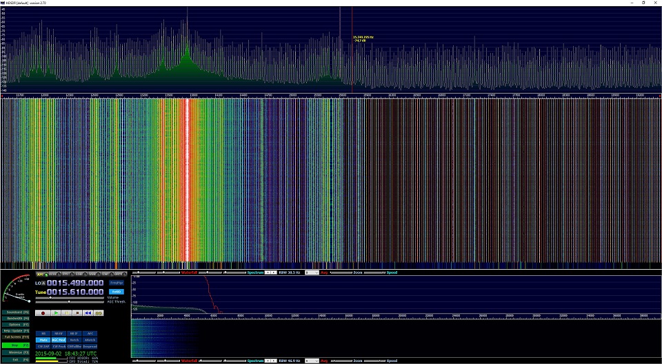

it tried a while to find out what happens when and why ... finally I have no idea what it could cause. It happens sometime, no reason why. Here it is how it looks like:
At the lower end of the waterfall you see the signals before it stops working. There's no energy saving on, sample rate is 8MS. I'll try it now with lower sample rates, but there's no other device on the port that the SDRPlay is connected to and thus the port should handle the data rate.
I'll keep you informed.
Eckhard

Hi,
I let SDRPlay run with HDSDR now for 24h @ 6MS, no problem up to now. So, it seems to be a bandwidth related issue. I go now over to 7MS. Let's see what happens.
Eckhard

Post by eckrot » Sat Sep 05, 2015 10:54 am
... and it just failed @7MS after app. 1h. So, it seems that (at least with my configuration) it can be operated stable only up to 6MS with the extio.dll. Now, I repeat the test if it works stable @8MS using SDRConsole.
Eckhard

Post by eckrot » Sun Sep 06, 2015 4:38 pm
... 8MS with SDRConsole is running 24h now without failure. Again: it seems that there is something in the latest extio.dll that is time-critical for sample rate > 6MS @ my I3-3220 system.
Eckhard
