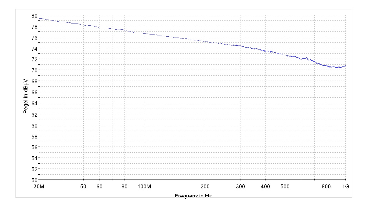

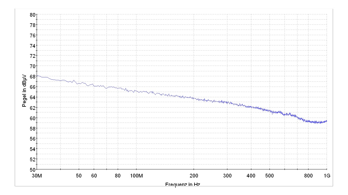

I use this Noise Source, a RSP1 and a Mini Circuits ZEDC-15-2B coupler. The noise source is really good, it becomes even better if you remove the third amplifier and insert a few dB attenuation between source and coupler. The reason for the high temperature of the source are the resistors used with the amplifiers.
I made some measurements of this Noise Source using a professional R&S spectrum analyser and EMC receiver. I also have values from 10kHz to 3GHz but they are numerical (txt). I have to convert it before I upload it.
If you use the source with all three amplifiers without any attenuation take care of your RSP1! It is overloaded by the wide signal rather fast.
Scan with 10kHz bandwidth:
Scan with 120kHz bandwidth:
