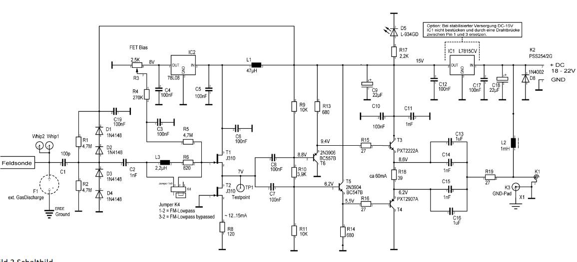

It is not my intention to blame something or someone. But I would neither recommend to use dual gate Mosfet nor to apply extra amplification in an active whip antenna. I know that dual gate Mosfets were the absolute must in the 80s of the last century and were often used in RF amplifiers and active antennas. I also have built such devices and had to learn that dual gate Mosfets have a poor IMD performance and in some cases high noise on lower frequencies.
The J310/U310 that PA0RDT uses is the better choice, but even this suffers from IMD when the bias of the gate is not fine adjusted for best IMD performance. Variations of the antenna use an active current sink (constant current source) in the source section of the JFet or even push/pull designs with complementary JFets (which are hard to get nowadays) to improve the IMD situation even more.
I cannot say if all problems reported with the antenna here are related to the Mosfet. But generally I think a Mosfet is not a good choice for this type of antenna when you want to have best results.

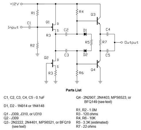

Sorry, but modifications of the bias T do not compensate the design of all the rest.
Chris Trask (among others) has built several whip amplifiers and recommends (among other designs) an input stage which has an active current sink as a load resistor. Source: Complementary Push-Pull Amplifiers for Active Antennas, Chris Trask, July 2013
Here is a practical solution from DL4ZAO which is inspired by Chris Trask's proposal and adds some useful parts. The most important one is a stabilized, adjustable gate bias for the J310 which should be set for best IMD with a two tone generator. Source: MegaWhip Aktivantenne, DL4ZAO, 2017
One can easily see that a good whip amplifier needs some more parts than a Mosfet and and a single output stage. This design avoids a complementary input stage with a J310 plus a J174, J270 or even J271. Parts which are very difficult to get on the market. It uses two J310 which are still in production.
