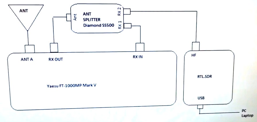

I'm waiting for my SDRPlay and I've been reading here and there about it and how to use it with my Yaesu FT-1000MP. Found an article that mentions that using a splitter/combiner, connected to the ant rf in/rf out, I may use it without any problems as transmitting is concerned. Anyone has any thoughts or comments about this? Appreciate any help. CU3AA, Joao

If by the rf in / rf out you mean a connection on the transceiver that switches that rf line out of the chain when you transmit, then you should be ok. One way or another, you need to switch the RSP out of line when you transmit, or you will blow it up. That's not really something you want to test to see it it's ok without taking it out of line, because it only takes once to blow it up.

Hi David, thanks for your reply.
As far as I understand, the SDRPlay is connected to the RX ant and when I transmit the circuit jumps to antenna A or B and (I guess) closes RX input. I send you the scheme so hope it helps to understand better the situation Hi Hi.
73 de CU3AA, Joao
