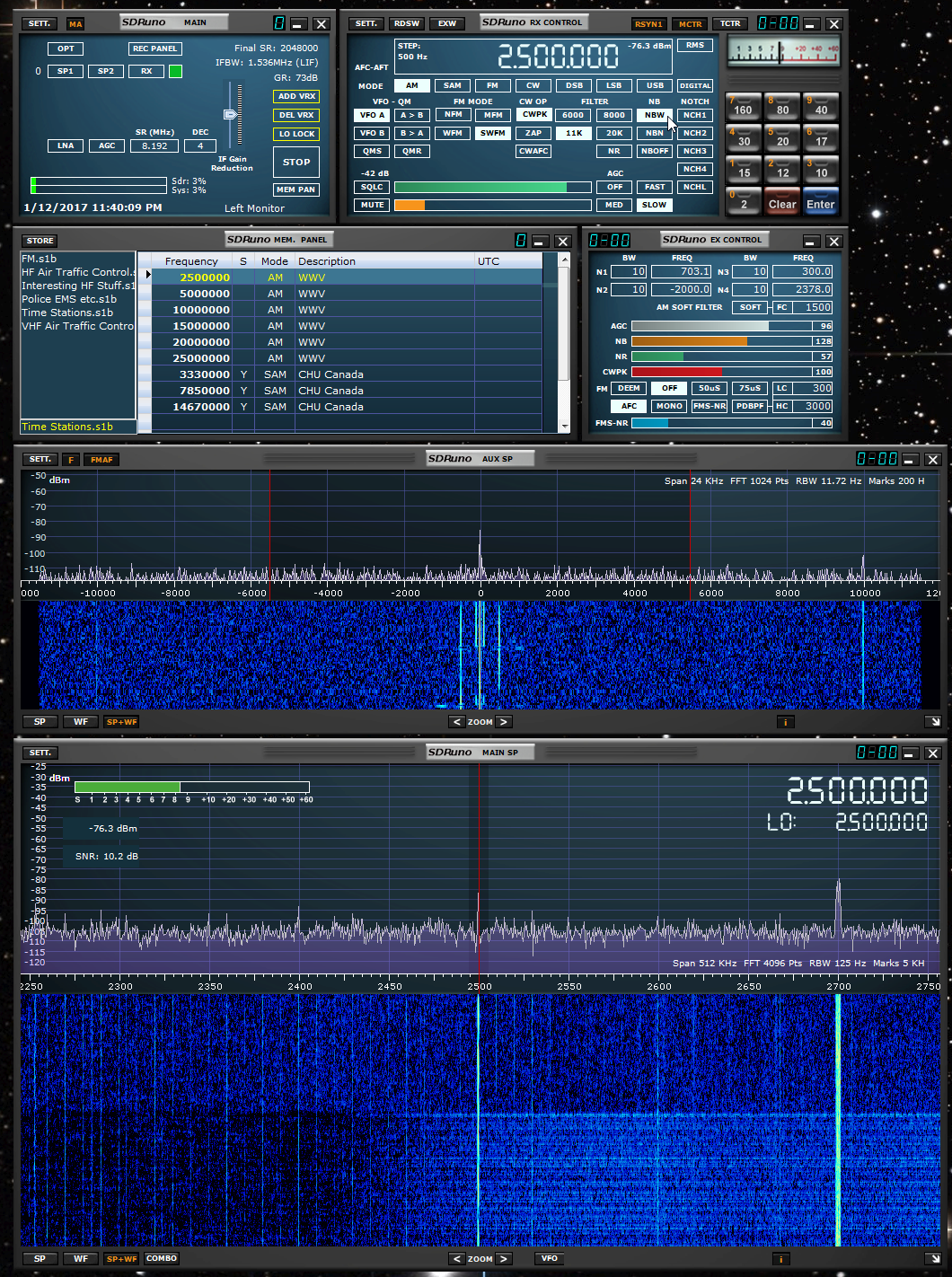

Up until reading this thread I haven't found the NB feature useful at all, because I just didn't discover what kind of noise it would blank.
Now that I see that it's for impulse noise, I tried it again and wow, it gives impressive results! Consider the night and day difference between the waterfalls showing in this screen grab, taken just after enabling the Noise Blanker. The sound went from a loud cross between a 60Hz electrical short circuit and a dragster idling to a completely legible WWV signal against a modest hiss.
There are some frequencies around here that have a 60Hz zzzzt sound on them. I think it must come from those high voltage electrostatic air filters in A/C units (and in Florida here, the A/C is on almost all the time). Bug zappers for viruses and bacteria.
Is there any reason the tooltip (popup) help for these controls can't give a clue what kinds of usage the features could be useful for? "Wide BW Noise Blanker" is simply too vague. No one would have to wonder what the NBW/NBN features would be useful for if the tooltip just said "Wide BW Noise Blanker - useful for smoothing impulse noise".
It's nice to have a forum, but even nicer to have the software help the user discover how to use it properly.
Now that I realize the NB feature can work so well, and have discovered that tweaking the NB level setting in the EX CONTROL window can really fine tune it, I do like it.
-Noel

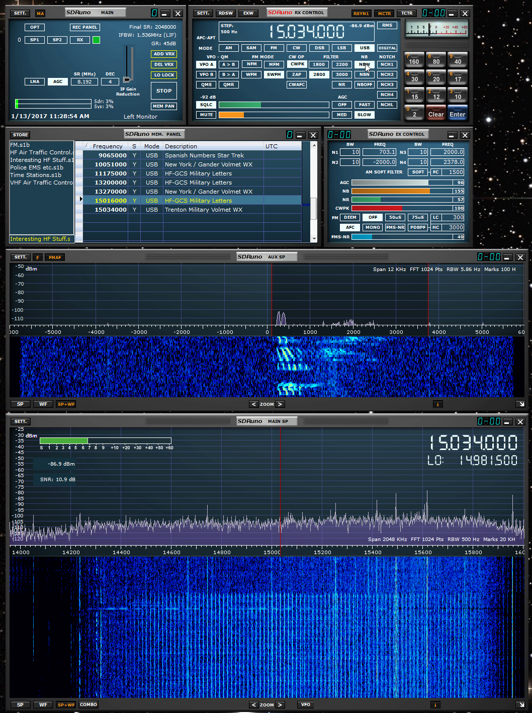

For what it's worth I just had a situation where the NB filter made a COMPLETELY unusable signal into something readable and actually quite clean.
I found Trenton Military Weather, USB on 15.034 MHz, completely unreadable because our washing machine has a computer control board that insists on broadcasting interference all across the band. Even though my antenna is outside and away from it, it completely destroys the HF band. It's not impulse noise, but shows up on the AUX SP as a band of interference about 1 kHz wide or a little more, and it repeats every 18 kHz or so.
Back before I got the SDRplay RSP1, for the longest time I just chose not to listen to my little SWL receiver whenever the washer was being run.
I saw this today in SDRuno and wondered, since it spread all across the band as a bunch of vertical lines, whether the Noise Blanking feature might take care of it. Wow, did it work well once I got the NB threshold in the EX CONTROL window set just right! Consider this screen grab. You can see in the MAIN SP waterfall where I enabled it. It made the signal not only readable, but quite pleasant to listen to. This is the kind of thing the S in SDR promised to bring to the party. It's great that it actually works so well.
-Noel
