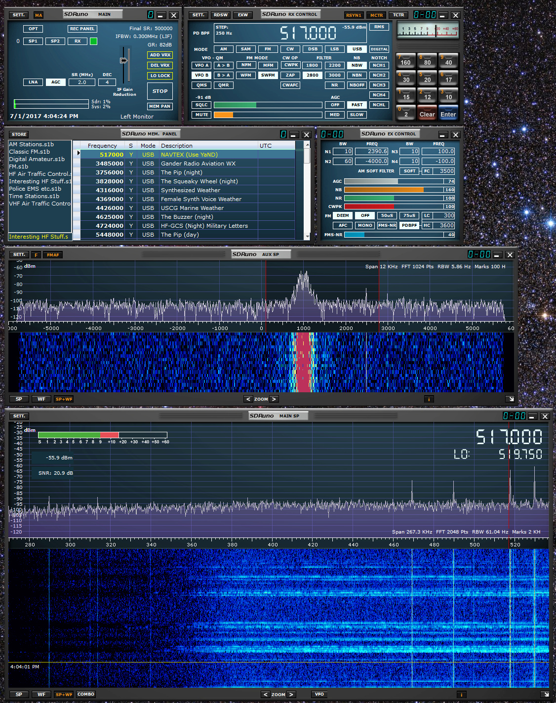

Right now I'm not getting anything around 520 kHz, but I have decoded NAVTEX with YaND or fldigi on that frequency before. At the time it was strong and I got a good copy. You can see from the screenshot that I had put it into my memory panel. I'll try to remember to listen in and capture it for you in the near future.

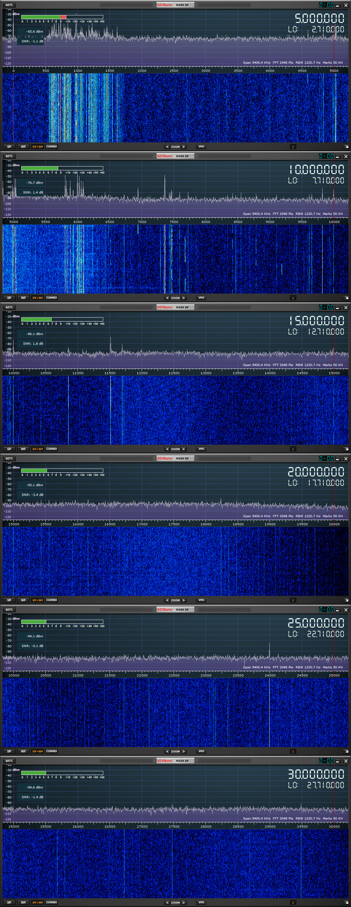

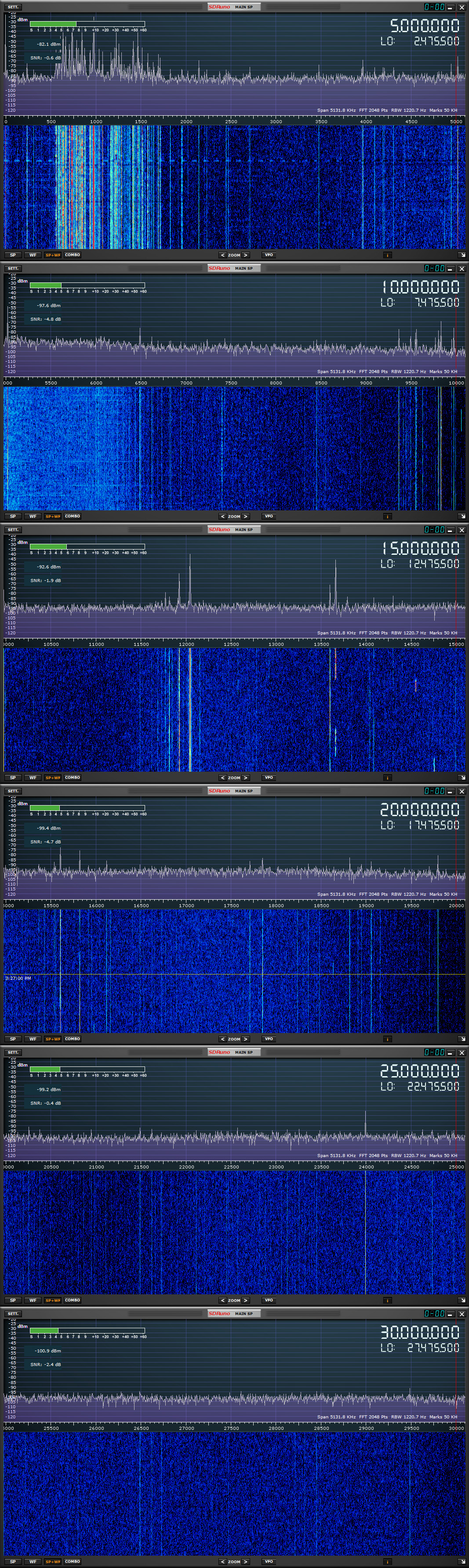

For fun, here are groups of screen grabs showing frequency spectra 5 MHz at a time, captured both last night and today. Everything frankly seems pretty dead, but in the interest of accuracy I'm posting them anyway. I can barely pick up WWV on any frequency right now, which is atypical. I'll follow up with more screen grabs when I see the bands get more active.
Night:
Day:

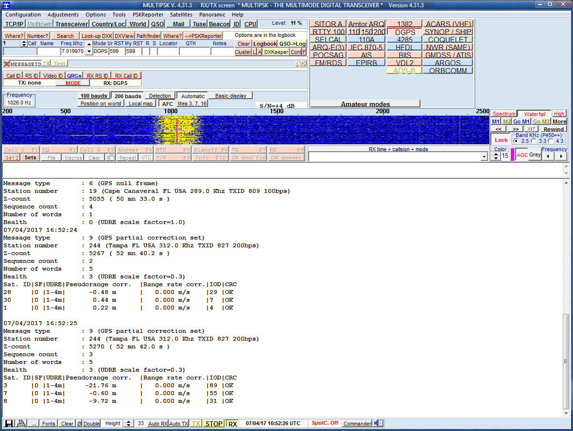

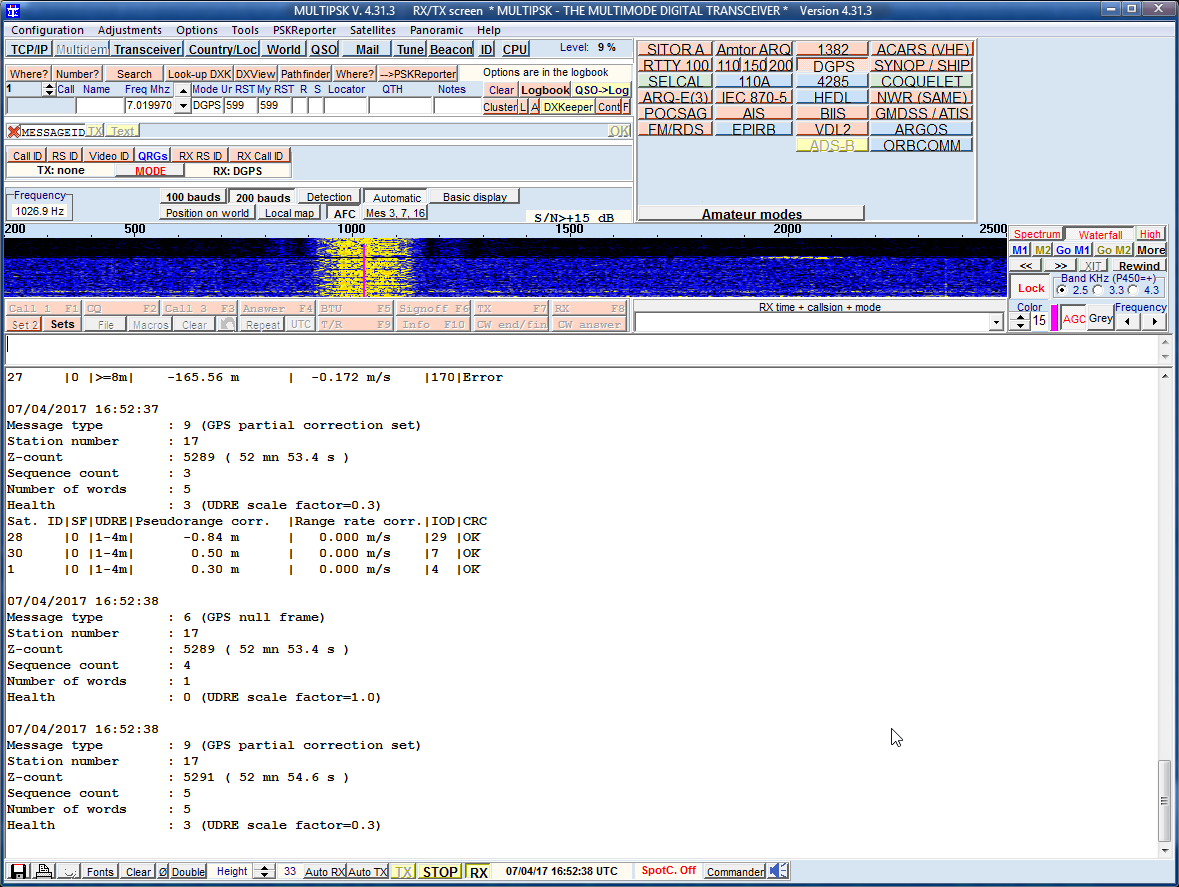

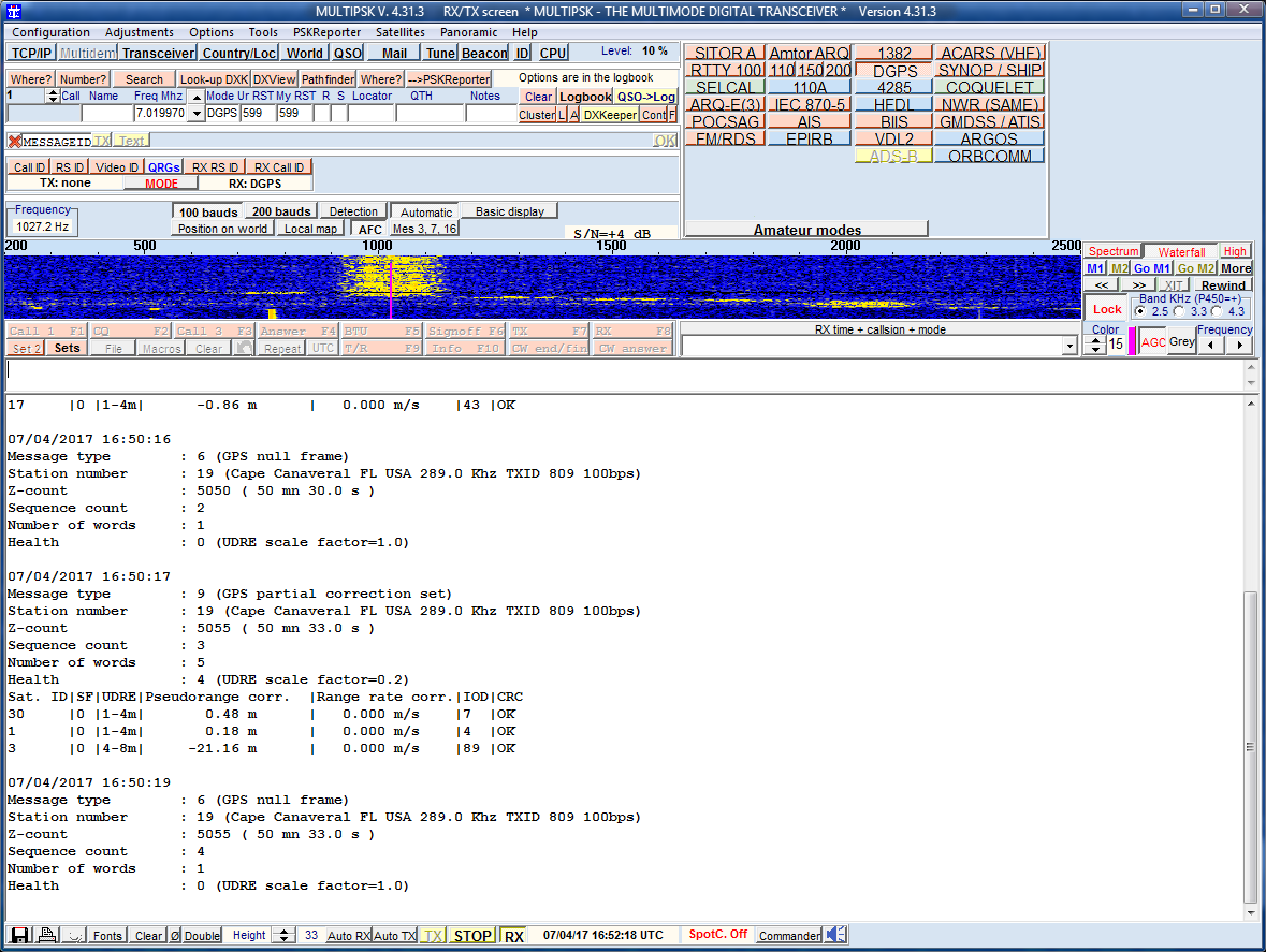

Postby NoelC » Fri Jul 07, 2017 3:40 pm
OK, I figured out that MultiPSK can decode DGPS stations. Here are a few grabs (I'm in southeast Florida; the furthest station in this set was from Tampa, I guess). One of the stations is listed only as "station 17". Not sure where that is.
-Noel
