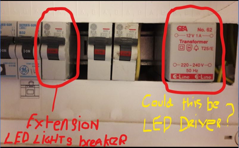

I am no electrician but the transformer, pictured below, was added when kitchen extension was built - I wonder if this is the offending item, have you any thoughts?
Thanks again
Adrian

Hello Adrian,
For me this transformer looks like a transformer for your doorbell. It is rather unusual to use this kind of transformers for LEDs. Transformers for doorbells often are simple transformers without any active component, they don't produce noise on the power lines. You should look for a switch mode power supply (SMPS). These power supplies may be inside the LED bulbs or if the lamps are fed with 12V in a small box which is connected to the mains.
Maybe your "doorbell transformer" is this box then there is a SMPS inside which causes the noise.
Wolfgang
