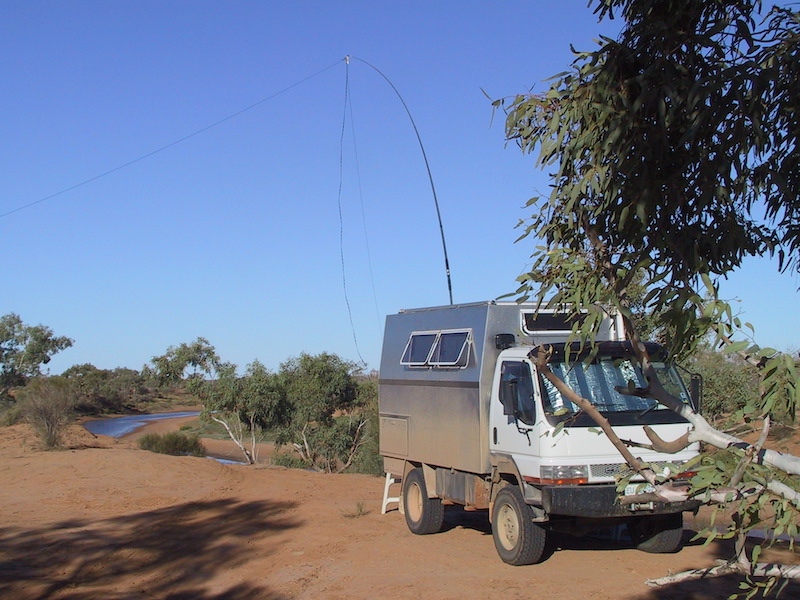

As to the finer points for use as a Tx ham antenna Bas, I did end up with the ZS6BKW, here it is in use:
The Traveller's Net in Australia is on 14.116MHz and I tried to maintain a more or less daily sched back to Tasmania while spending 8 months in the scrub. The really tough thing about that is as I travelled, the distance varied between 300k to 3,700k which meant the 20m skip distance was changing the whole time and that was a challenge. It came down to trying to manipulate the vertical angle of take off to suit the distance. 50% of the time I used either a vertical or a 150m long inverted L instead of a doublet.
The bottom line is as per your example of the G5RV Bas, antennas are so easy to make and so much fun they are the perfect complement for SDRplay products.
Cheers, Phil
