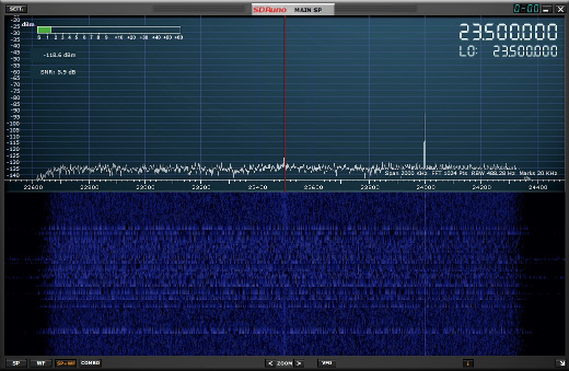

I dual boot Linux Mint and Windows 7 on this PC and the Windows installation didn't have SDRUno, or RSP drivers installed. A quick download and install and then it starts with default settings. With no antenna connected, having simply clicked the SP1 and Play buttons in the MAIN window, the waterfall and pan shows up with 3.5MHz at centre. Hover over where the tens of MHz would be indicated (one left of the 3) and scroll there to get 23.5MHz and you should see the internal oscillator at 24MHz.
If you then touch the centre pin with a pin (or small screwdriver while you're touching the metal) you should see lines across the waterfall as below, where I was purposely not making a good connection.
It's an easy test and doesn't need an antenna, or any complicated settings, but should prove if it's being a radio, or not...
Would have looked better at full size, but it was too big at 271,801 bytes :roll:
