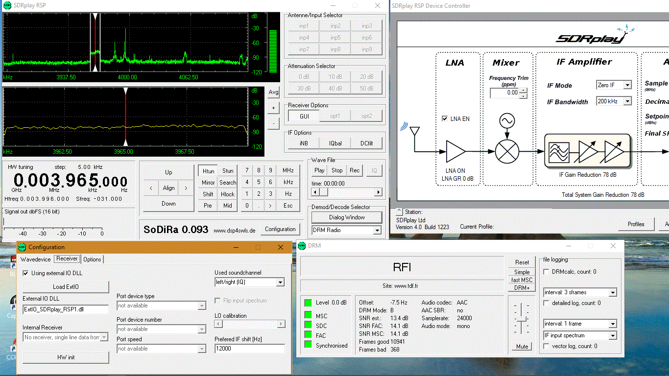

With Sodira you can use ExtIO_SDRplay_RSP1.dll and control directly your SDRPlay.
On the GUI I recommend using Zero IF with 200KHz bandwidth as Sodira is not suited for wide bandwidth.
Also check enable post tuner DC/IQ Compensation in the advanced panel to avoid the zero IF line on the picture above
Paul
