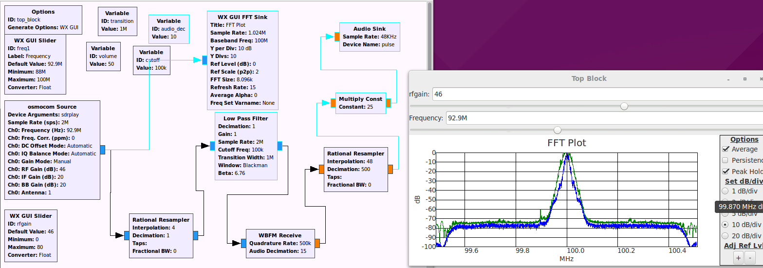

Gqrx was a bit temperamental and I started wondering if the device worked at all so, as I had gone to the trouble of installing gnu-radio, I thought I would spin up my own radio. The attached shows the first hack which nicely tunes the FM broadcast band and confirms the device works.

GNU radio companion screen shot
