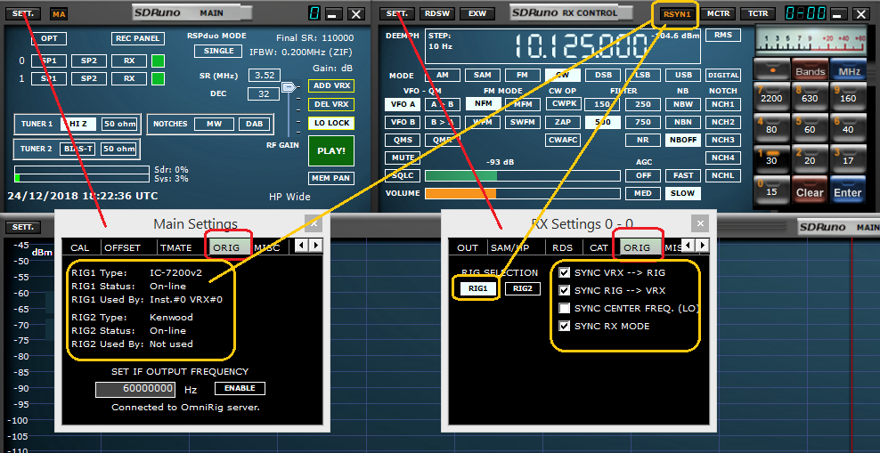

The user manual has a section covering how to set up SDRuno to work with an external rig. There are also several videos on the SDRplay YouTube channel. Here are a few pointers to get you going.
1. Setup OmniRig with the two receivers and make sure you use the recommended baud rate, parity and number of stop bits recommended for each rig you are using.
2. In the Main window under SETTings you will find the ORIG tab. Make sure your Kenwood and Icom are online or OmniRig is not setup correctly.
3. Each VRX can connect to only one OmniRig device at a time. You select Rig1 or Rig2 under SETTings in VRX0 or VRX1. Check the options as shown below. If you look in the Main Window SETTings you can see which VRX is assigned to Rig1 and Rig2.
4. You need to activate the control of the rig for the VRX by clicking RSYN1 or RSYN 2 in the title bar of the VRX as shown below.
Hope this helps - Roger
