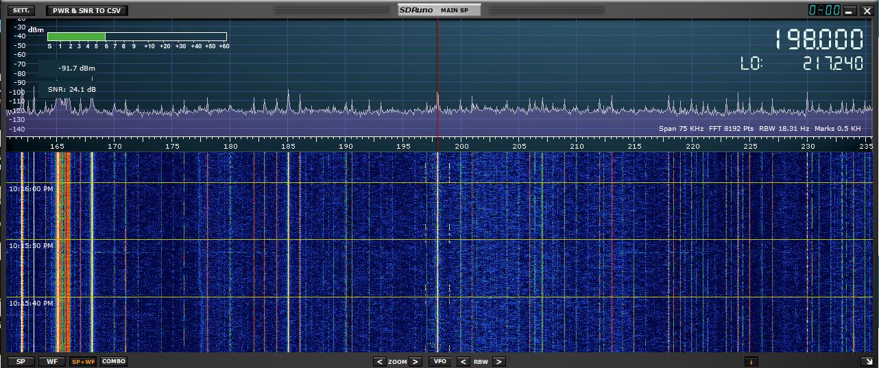

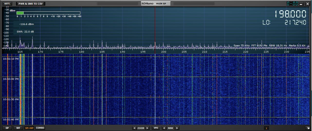

As a test, I have my antenna connected to the A port. It's raining here so noise levels are higher. Here are 2 screenshots, the first is with Port A the second is HiZ. I can hear DIW in Dixon NC on both ports. For comparison, on A it is at -116.6 dbm with an SNR of 22 On the Hi-Z it is at -91.7dbm with a 24 SNR. I've made no other changes in settings to make this comparison. AGC was on manual at this time set to 30db, RF gain at maximum. The receiver was tuned to 198khz, DIW's carrier frequency. You can see the morse ID at about 1 khz above and below the carrier frequency in the screenshots.
Port A.JPG (224.68 KiB) Viewed 37199 times
Port Hi-Z.JPG (235.69 KiB) Viewed 37199 times

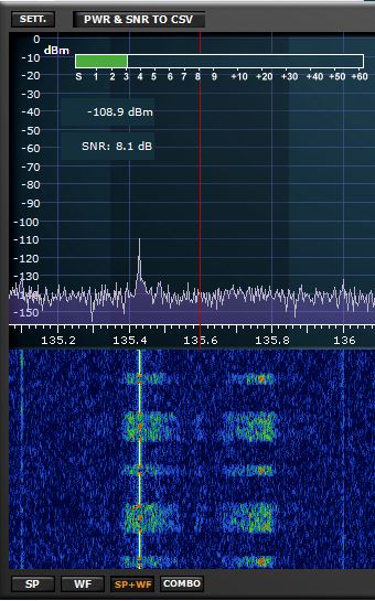

You are missing something.
Schermafdruk op 2019-02-19 13-53-54.png (85.95 KiB) Viewed 36723 times
I have a signal 135.6
