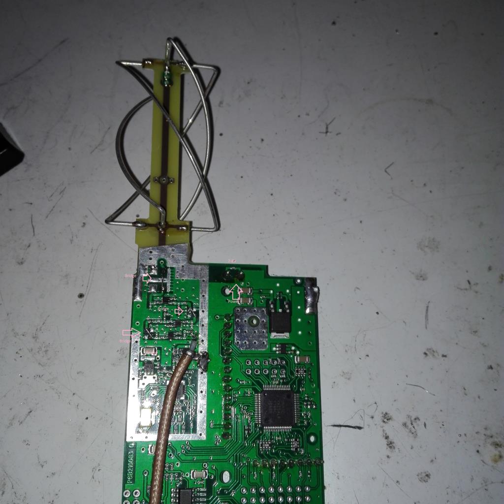

I guess he is using a Vaisala RS92 weather sonde, they send them up all around the world a couple times a day and is just to track and go get them when they fall back down, google Radiosonde. I have moded one to, not tested yet tho.

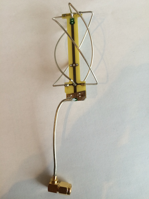

Yes, your guess is exactly right. Although I don't use the electronics of the weather sonde. I just cut the PCB and soldered on a sami rigid coax with SMA connector:
You could try to build a QFH by yourself but i suppose it might be a little bit difficult because of the small size.
On the SDRPlay page on Facebook Paul Jones posted a design for a vivaldi-antenna. This type of antenna might be easier to build. Just remember that vivaldi antennas are directional.
