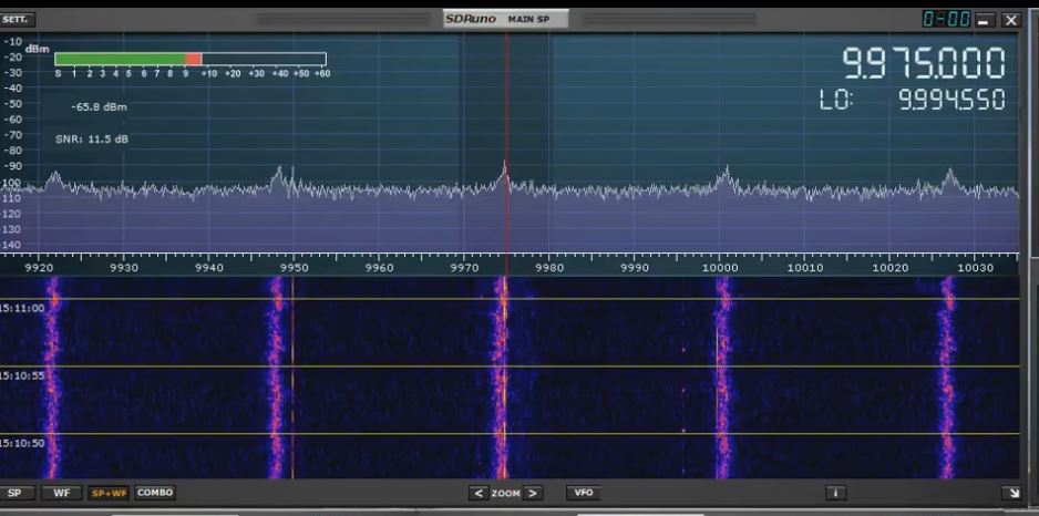

I have the same issue and run the laptop unplugged, however I'm still plagued with interference across all band - but worst on HF, see below. I've wrapped the USB through a ferrite ring - with no effect (again, laptop is unplugged). My head is wrecked, as I have excluded any LEDs in the house etc. I live about 100m from transmission lines and I'm wondering could this be it?
Many thanks in advance for any ideas
73 Adrian
73 Adrian

Hello,EastPier wrote:I have the same issue and run the laptop unplugged, however I'm still plagued with interference across all band
a typical pattern of switched mode devices, mainly switched power supplies. Harmonics spaced between appr. 15 kHz and appr. 100 kHz, depending on the device. We all have such patterns (more or less) in our receivers. When your own house is "clean" they certainly come from neighbouring houses. I myself, for example, "receive" harmonics from switched power supplies in a distance of 80 metres with S8. Yes, transmission lines can carry the noise and help to distribute it. But very often the noise is coming directly from the power lines in neighbouring houses.
You can (in case the source is not your own house):
1. Talk to your neighbours and persuade them to install filters. But they will not understand and ignore you.
2. Call the authorities. But in many countries noise free radio reception is no longer on their agenda as the politicians say, classical radio reception is no longer required. You have the internet to listen to radio stations. And the level or your noise with appr. 10 dB above noisefloor is very low. No reason for any authority to take action.
Switched power supplies are only the tip of the iceberg. There are a lot more sources, like power line communications (PLC) and all the rest. And there are more to come soon: Charging docks for pedelecs and (extremely evil) electric cars with powers of 20 to 100 kW and Wireless Power Transfer.
