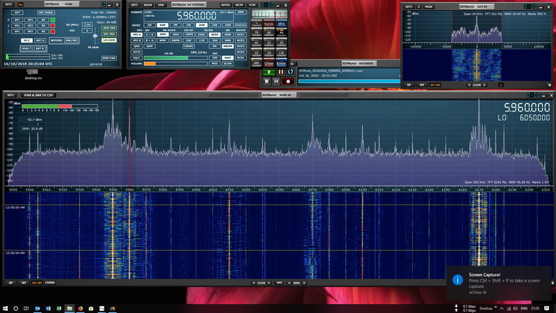

IQ file records and replays fine. On replay, the time mark on the SP1 waterfall shows "12:00:00 AM" on every mark. The recorder/player shows the correct time when it is replaying. Is this a known bug?
The file plays fine on SDRConsole and displays the correct time there.
Regards
Noel
2 sdruno replay.jpg (153.97 KiB) Viewed 23163 times

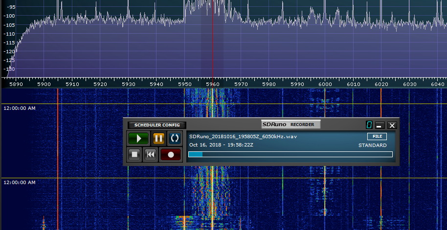

This screen capture may be more readable....
sdr replay.jpg (218.69 KiB) Viewed 23162 times

My issue with the time markings is when i am replaying an IQ recording. Then all the time-marks on the main and auxilliary spectra show 12:00:00 AM. Al time marks are correct when using the SDR in real-time.
Show UTC is checked and working correctly....
Noel.

Thanks Mike. At least I know it's not unique to my setup! The correct time does show in the recorder panel during playback (see my 2nd post above) but not in the spectra displays.
