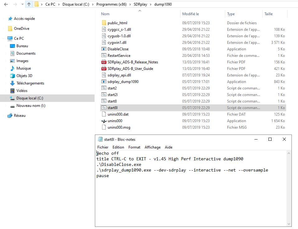

If you open a command prompt and navigate to... C:\Program Files (x86)\SDRplay\dump1090

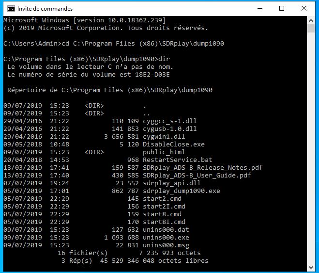

Sorry, I don't know to 'navigate' there and access these cmd with the prompt command ... (I have C:\Users\Admin>_ first ; what to type from here ?
I tried cd C:\Program Files (x86)\SDRplay\dump1090 but it does not show what you mention ...
From C:\Program Files (x86)\SDRplay\dump1090, then right-click and 'modify' a .txt window open and I can see the line you mention (see capture).
Is it OK to add the command line option here ?

Hello Patrick,
Assuming you have the correct permissions to edit those files directly, then you can modify them that way.
The --rspduo-single will allow you to use Zero IF mode - it can be used with either tuner, but only in single tuner mode - I thought it might be an interesting comparison for you, but it shouldn't be essential for you to use it.

I managed to display the directory, but now how do I access start8I.cmd content to add the text at the end ?

Post by sdrplay » Fri Jul 26, 2019 12:17 pm
you can edit it in notepad or some other editor you have.
