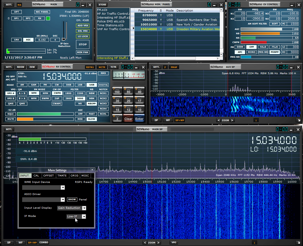

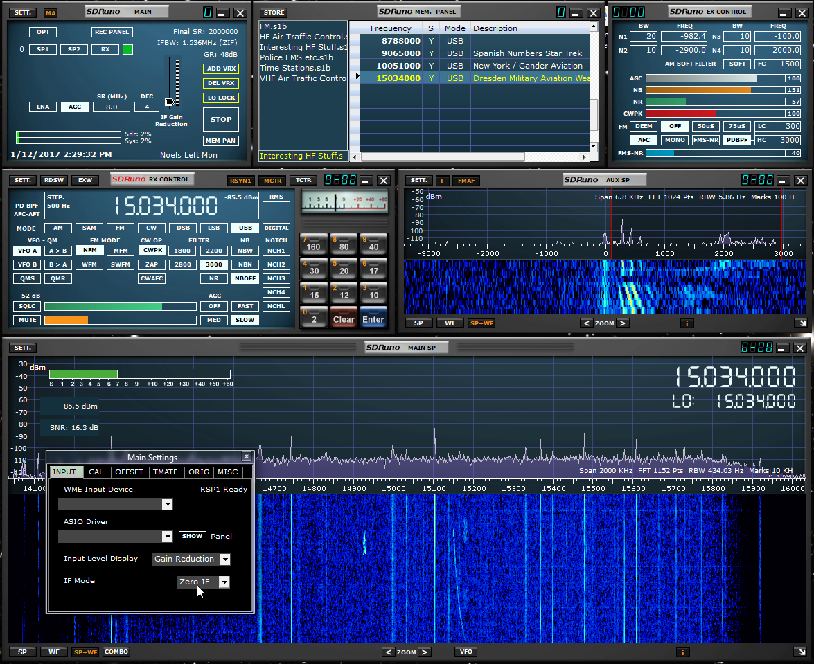

Maybe it's an SDRuno thing, but when tuned to the center scale frequency and Zero IF is selected I don't see a notch so much as a ghost signal that distorts the reception. The sound for USB isn't bad, because the low frequencies are excluded, but AM stations just sound distorted.
Examples: Center scale right now with Low IF:
...And with Zero IF. Note the nasty stuff on center frequency:
