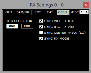

1. In SDR Uno make sure that you have checked the boxes shown below. If these are checked I suspect the problem is not in SDRUno because the communications with the Omni-Rig program are generic CAT commands and not radio specific. My own setup works great with Omni-Rig and many other users have had success.

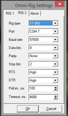

2. The problem is probably with the rig definition file in Omni-Rig or the port settings that you have used. Verify that the Com port #, baud rate, number of data bits, number of stop bits, parity bit and RTS/DTR match what you are using in FLRig and TRX manager. If that does not fix it there may be an error in the FT900 rig.ini file. The author of the program did not test all of these. Some are from other users. You can see what is happening if you put Omni-Rig into log mode. Here is how to do it.
To enable error logging, stop all programs that use OmniRig and add the following lines to the
OmniRig.ini file:
[Debug]
Log=1
The log file (OmniRig.log) is created in the OmniRig directory upon the exit from all programs that use OmniRig, and is cleared on the next start of the program.
3. If you still can't find the problem you can use the Omni-Rig test client to try and figure out what is going wrong.
Details are here >> http://dxatlas.com/omnirig/BetaTest.txt
