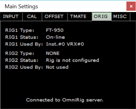

I can't edit - keep getting 'must choose two poll options' despite this not being a poll ...
Using the dvb-t+dab+fm USB dongle, I do not have the IF Output Mode as described in the manual. Is this because I am not using an RSP?
The IF box is not present in my copy of SDRuno v 1.22

Re: SDRuno with Yaesu FT-950
Are you sure you are using the main SDRuno.exe and not the SDRuno ExtIO executable?
If so, please show the About panel (Main Window -> OPT -> About)
I'm using SDRuno 1.22 with Yaesu FT-950 in IF output mode with no problems.
Oh I've just seen you are using a dongle - IF output mode is only supported with RSPs in SDRuno using the main executable.
