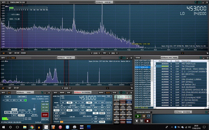

Spectrum - drop-off.jpg (197.48 KiB) Viewed 26039 times
If this works, it's the imge of the spectrum where mouse scroling ceases to tune the receiver (as previously expained (or attempted to).

You have a sample rate of 2MHz and a decimation of 8 which gives you a total sample rate of 250kHz and the IF bandwidth is set to 200kHz. The LO is set to 342kHz, so you are just seeing the edge of the IF filter rolloff.
Looks normal to me.
