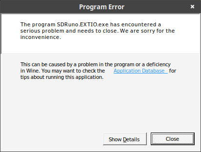

SDRplay have just released version SDRuno 1.3 which has the new scanner feature. Although I have not had an in-depth look at it yet, when I installed it on WINE in Linux, I found that the ExtIO version no longer works but instead, generates an "Unhandled exception: page fault on read access..." error. A small blank Window with the title 'Sdruno' is spawned at the same time and closes along with the error dialogue when it shut down.
The first line of the detail shows:
I have attached screenshot of the error dialogue I am getting when I try to run SDRuno ExtIO (version 1.22) after installing SDRuno version 1.3. Fortunately, it is easy enough to revert back to 1.22 after installing version 1.3 just by re-installing version 1.22, whereupon the existing SDRuno ExtIO version will start to work again. Looking at the downloads on SDRplay, I notice that version 1.22 (annotated ExtIO as opposed to All RSP's) is still available for download from SDRplay and this is the version that will be required to install SDRuno ExtIO edition in WINE on Linux.
Can I ask SDRplay whether an updated ExtIO version is planned for release at some point?
Initially I thought that this might be some obscure problem with the 32-bit architecture, but digging a little further into this, I discovered that the version 1.3 installer does not come bundled with the ExtIO edition of SDRuno like version 1.22 did. Consequently after installing version 1.3, SDRuno and the support files get updated to version 1.3 while SDRuno ExtIO edition still remains at version 1.22 on the system. It is perhaps not too far fetched to suppose that perhaps version 1.22 of SDRuno ExtIO would now have compatibility issues with the later version of the support files installed with SDRuno version 1.3.Unhandled exception: page fault on read access to 0x00000f30 in 32-bit code (0x00430965)
- Screenshot from 2019-03-14 13-02-04.png (16.67 KiB) Viewed 41181 times

You cannot install 1.3 and 1.22 into the same directory as this will corrupt the ExtIO version.
The reason that the ExtIO version had to stop development was that we have had to focus on RSP integration into SDRuno and quite a number of the improvements are not compatible with the support for other hardware. There may be some small improvements made to the ExtIO version at some point, but I can't say what they would be or when they would happen I'm afraid.
