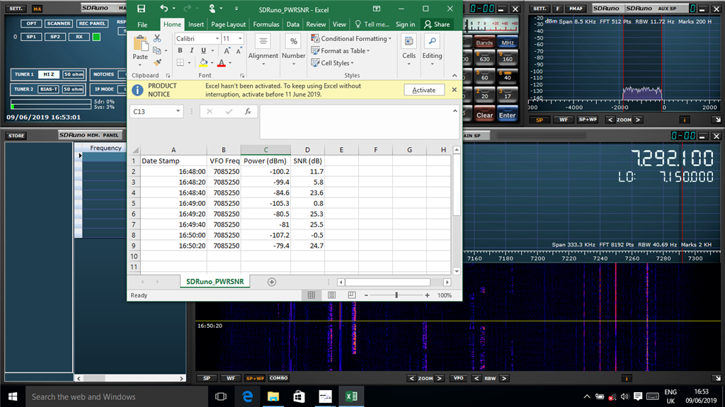

Can you run again with the waterfall displayed so that I can see the time intervals and also show the seconds in the spreadsheet please.
I suspect it's something to do with the waterfall not being displayed - the CSV file is created from the time mark interval code which is probably not being run correctly if the waterfall isn't being shown.

Hi SDRplay Support,
It is really very simple.....when you know it. The time stamp now works always, even without the waterfall display. The thing is, you must set the DATE/HOUR column in HH:MM:SS in EXCEL. By chance mine was in HH:MM. Sorry for the trouble given!!
Thanks & kind regards,
