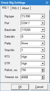

I assume that your TS590 is connected to a port COM 7 on your PC.
Have you set up the TS590 in Omnirig Settings as RIG1 (or RIG2)?
You cannot use this COM port simultaneously with multiple programs (unless you make use of COM port splitters, but this not stuff for a beginner). All programs using this port must be closed (HRD, Kenwood control program) otherwise Omnirig cannot open the port.
The CAT control setting in SDRuno is something completely different. It does not control your rigs. Better de-activate a COM 7 there to avoid just another port conflict.
When Omnirig is running on COM 7 you cannot control your TS590 with HRD because Omnirig occupies the port. To make multiple access of one COM port available you must use the "splitter" technology that comes with e. g. VSPE. I decscribed here
