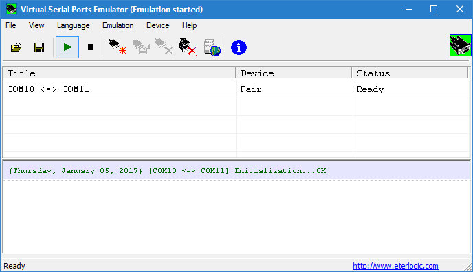

When HRD uses COM10 you must specify COM11 in SDRuno (or vice versa). You cannot use the same COM port on both sides unless you use splitters.
Which COM port emulator are you using? (VSPE, com0com, VSP Manager by K5FR...)
When you created the virtual COM port pair, did the emulator (VSPE, com0com, VSP Manager by K5FR or whatever you use) report success? If not, you are probably trying to create a pair from COM ports which are already in use. The emulator must report "OK" or something. Did you verify this in your emulator?
The image shows an example with VSPE.

Thanks for the reply and the pic! I had the port set-up incorrectly. Everything is now working.DanubeBCL wrote:When HRD uses COM10 you must specify COM11 in SDRuno (or vice versa). You cannot use the same COM port on both sides unless you use splitters.
