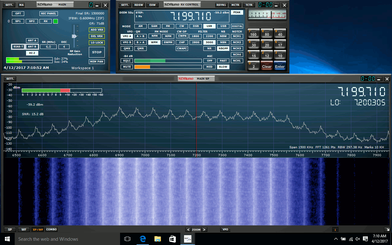

What are these recurring signal peaks? Do i have an incorrect setting?

Looks like you have a strong local source of interference, maybe from a switch-mode psu or a plasma TV. It may even be from your own home/shack. What antenna system are you using?

My present antenna is a longwire, end-fed to the high impedence input of the SDR. I plan to make up several 9:1 unun's with different cores (considering 2,6,31,43,52,61) and switch between them depending upon the frequency range I am observing. Probably a bit overkill, but they are inexpensive and easy to make. If someone reading this has already done that with poor results, PLEASE TELL ME and save me some trouble!!
That signal seems to be around 60K or so apart. I also thought about a switching power supply being the culprit and turned off my laptops as well as the CFL bulbs. I DIDN'T turn off the FT990 but if it were making that kind of signal, I would have thought I would have noticed it long ago; I am relatively sure that it is has a switching power supply, however, and will do that check tomorrow.

Appr. 75 kHz spacing. Could be a switched power supply or plasma/LCD telly, indeed.
If the source is in your own home (room), try a common mode choke in the coaxial cable at the receiver input or better ban every switched PS from your house. When the source is your neighbour: Good luck with your negotiations!
The peak at 7.2 MHz indicates that a resonant ham band antenna (dipole?) is used. Just guessed.

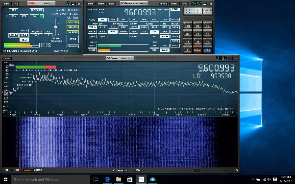

Further investigation revealed a noise signal of 12db strength being generated either the by the laptop running the software or the SDR itself. See the attached screenshot.
Looking at the CPU usage at 10MHz and Decimation 1, I think that noise in my receiver is being generated by the laptop. I do have ferrites ordered for the USB cable as well as other connecting cables and see if that helps.
Sniffing for RF with my Startek, the SDR is producing some, the laptop is producing some, the laptop power supply is producing some. Unplugging the SDR didn't reduce the receiver noise, since the laptop is still working away. Stopping the software reduced the noise by 12db. Turning off the laptop (a Dell Inspiron with the Dell switching power supply) dropped the noise level by another 12db and effectively left only band noise as the hash was gone. Interesting, since my Dell Latitude does not seem to be making any noise. I'll post this message and then turn off the Latitude and see what happens and post the results.

Stephen - you mention a longwire antenna connected to the Hi-z input. Is this a longwire *directly* into the RX? If so, I'm sure you know that these days bringing a high-impedance wire into your shack is a cast-iron way of picking up every bit of noise in your own house and your neighbours. A coax feed to a transformer-fed longwire would be better.

This is no good arrangement. Keep everything which acts like an antenna as far away as possible from your house (and neighbouring houses), match the antenna to 50 Ohms at its best and use coaxial cables to bring the signals into the house. Place common mode chokes at the receiver's ant input and use good grounding at the receiver as well as near the antenna feedpoint outside. Computers sometimes need extra grounding and noise filters in their power lines. Some people even found it necessary to bury the coaxial cable as far as possible in the ground to avoid common mode noise from the neighbourhood entering the cable.StephenT wrote:the longwire comes directly into the shack and the SDR.
But this all of course does'nt help anything when the noise is picked up by the antenna itself.
The days when we could receive something inside or close to a building without noise are over.

Hi ... had the same problem. Replacing the USB cable with one with Ferrites on both ends did nothing to help. After watching the system left on for several hours, I traced it down to the FURNACE in my home. I happened to be in the shack when the furnace went on, at the same time your screen shot started via the SDR manual turn off of the furnace confirmed the interference. Some clamp on ferrite beads on the power lines going to the furnace controller killed it dead ! The RSP-2 is better than the RSP-1 against interference, but it is still highly susceptible ... Be aware, it could be anything with a microprocessor or switching controller in your home or your neighbors if they are close to your antenna ...
