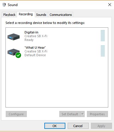

Run Wxtoimg. Select File----Mixer Control in Wxtoimg. Your PC's list of recording options will appear. If 'What You Hear' or 'Stereo Mix' is not shown, it is either not supported or disabled. See this link to enable it (if disabled):
https://www.howtogeek.com/howto/39532/h ... ord-audio/
Mixer Control.JPG (28.99 KiB) Viewed 41382 times
If Stereo Mix or What you hear is not supported by your sound card you can still use VBCable: https://www.vb-audio.com/Cable/

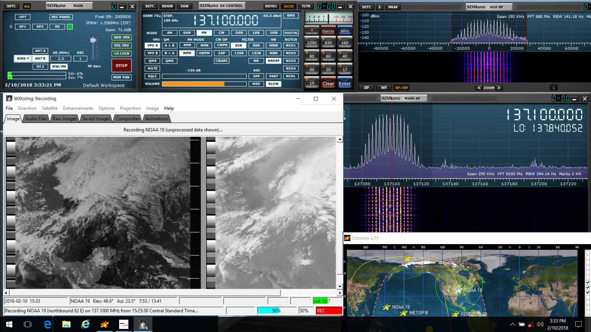

Post by RSP2user » Fri May 04, 2018 10:39 pm
Narrow band FM mode is too narrow, if using SDRuno. To properly receive the FM signal from NOAA orbital weather satellites, taking into account Doppler shift during the pass plus the bandwidth of the signal, you should have a bandwidth setting on your receiver of around 50kHz. In SDRuno, this is achieved by selecting WFM and then slightly narrowing the bandwidth from 60kHz to around 50kHz in the AUX SP window (select and drag the edge of the shown bandwidth area). Also, WXtoIMG generally requires the audio output from the receiver software (e.g., SDRuno or equivalent) to be looped back to the audio input so that WXtoIMG can receive it. This type of setup is discussed in detail here: https://www.sdrplay.com/community/viewt ... f=5&t=2529
