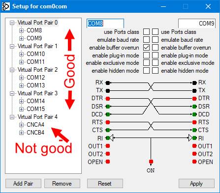

Hello Henry,
I assume you use com0com. com0com proposes COM port names which cannot be used by some softwares. The softwares expect a denomination like COM[some number], but not random letters and numbers as com0com proposes.
Go into the com0com setup and rename your CNCB0, CNCB1 to COM12, COM13 (or whatever port is still free in your system). Then select one of these in SDRuno, the other one in CSVUB.
The "Return" thing SDRplay Support just wrote does not work for me. Only COM[some number] works.

Yes, and also VSPE is working too, of course.
In my expierence I have learned to avoid COM port names like CNCB0 or something. They work in SDRunoEXTIO here, but I had problems in SDRuno 1.2 when I tried to reconstruct Henry's problem.
But no worry. It's working for Henry now.
But I still recommend to name COM ports COM1, COM2 a. s. o. There are some applications where the COM port enumeration fails when the names do not start with COM... E. g. the Perseus SDR software olny accepts a number and adds COM... automatically. Here you have no chance at all to enter something like CNCB0.
