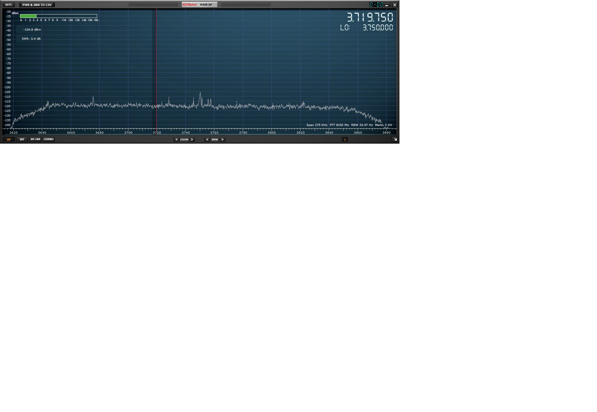

Taking as reference the table shown on Wikipedia (https://en.wikipedia.org/wiki/S_meter), I noted a discrepancy between the SP1 dBm scale and S meter reading. The S-meter is 3 S points higher, more or less. Is there a way to calibrate the S meter Vs SP1 dBm?

First of all I want to higlight my total satisfacion for the SDRPlay. It is a true little great receiver.
I work mainly in HF with a passive resonant home made magnetic loop placed in my balcony at 2nd floor of 8th.
Despite of so poor conditions I had confirmed QSO from VK, LU (tierra del fuego), Washington state, etc.
For strong signals I see a good match too. The discrepancy is Is for the weak signals.
I attach a hardcopy of SP1 showing a floor noise of -120 dBm (about) and a S3.5.
I'm using a SDRPlay 2 Pro.
Thank you in advance.

Re: S-meter Vs dbm
Hello IZ2245SWL,
You power reading is -104 dBm (31 dB below S9) in the LSB bandwidth of your demodulator, which is pretty well spot on. See the reading above the SNR meter in the SP1 display.
The -120 dBm noise floor level is the noise power within the resolution bandwidth of the SP1 display which is only 33.57 Hz. That is why you perceive a discrepancy.
SDRplay Tech_Support
Re: S-meter Vs dbm
I installed the SDRUNO 1.2 and changing the new RBW funtionlity of SP1 I understood the stuff.
