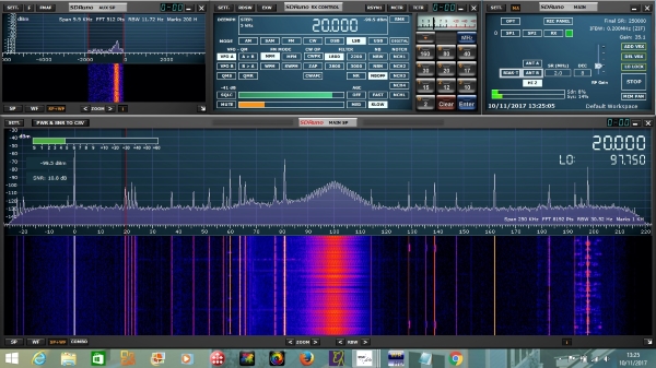

Don't forget the RSP-2 has a MW(AM) rejector which you can enable. It puts about 30dB attenuation in from 500 KHz to 1.7 MHz and it may help you. Below is a shot of how LF looks here in NW England on the RSP2 using the Hi-z input with an external 500 KHz filter. Antenna is a Wellbrook 1530 active loop. I use the Hi-z input as the LF response of the other inputs is poor.
- lfsmall.jpg (180.61 KiB) Viewed 33312 times
