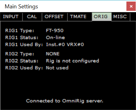

Re: trying to use SDRuno with Kenwood TS-850S
Andy - the IF OUTPUT is missing from my SDRuno. How do I get to this setting?
- Untitled.png (32.98 KiB) Viewed 36081 times
