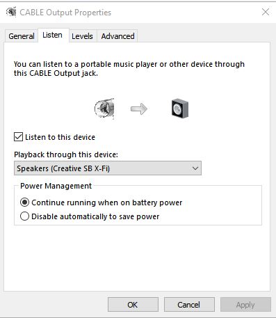

Post by Mike2459 » Tue Mar 13, 2018 1:17 am
In addition to what Lenah mentioned above you may also have to select your speakers (at Playback through this device:) if they are not the default output device - mine wasn't - SPDIF was the default, which I don't use.
