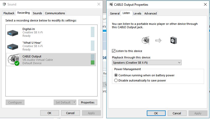

Post by Mike2459 » Fri Mar 23, 2018 6:02 pm
Do you have 'Listen to this Device' checked in the Listen Tab of Cable Output Properties? Cable Output will be listed as a Recording Device

Post by wa8nwt » Fri Mar 23, 2018 6:14 pm
No, did not have "Listen to this device" checked. I will have to try that later though when home. . Is that option in VAC or within SDRUno? I'm using VB-Audio program. I lost my key code for VAC, so may have to repurchase .

Post by Mike2459 » Fri Mar 23, 2018 7:46 pm
'Listen to this device" is a property of VAC Cable Output. (Right click on the speaker icon in the taskbar & select 'Recording Devices')

Post by wa8nwt » Tue Mar 27, 2018 5:18 pm
Thank you Mike. That took care of the issue with audio and VAC.
