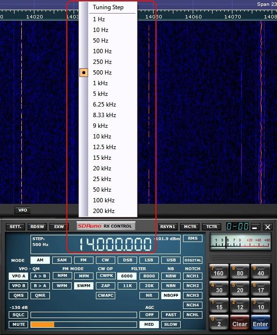

Post by hamrad » Sat Mar 24, 2018 12:46 pm
I see you can change the step size for each mode with a pulldown menu but how to you get that menu.

Post by sdrplay » Sat Mar 24, 2018 1:46 pm
right click on the frequency display in the RX control window

Re: Ver 1.22 Menus
Post by Mike2459 » Fri May 11, 2018 3:07 pm
Pages from v1.jpg (130.52 KiB) Viewed 18479 times
AFAIK there is no provision in SDRUno to store user defined bandwidth settings.
Section 3.8 of SDRUno version v1.2 manual, not in 1.22 version!!
3.8 Changing the tuning step
Each Mode has a default tuning step size. This can be changed by Right-clicking on the RX Control frequency dial: the dial step menu will popup. Select the desired tuning step.
