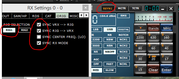

Yes Omni-Rig shows up in two places. You only need to change the one in the Main window if you are using SDRuno in panadapter mode with input from the IF of your transceiver. In the VRX you select which rig you want (1 or 2) and you have to click RSYN on the window border to use Omni-Rig with that VRX.

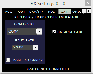

So in the RX Control VRX I have CAT disabled. I enabled it in the Main VRX and clicked on RSYNC1 in the RX Control VRX.

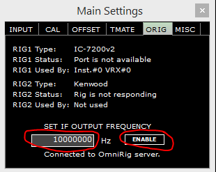

Try the following:
Disable Cat function...
Set your IF frequency and enable this function...
Install and Run OmniRig
