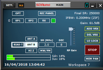

If you have adjusted the Gain/Gain Reduction to your satisfaction on the Main Panel (default is Gain reuction. but selectable to Gain under the Main Panel "Sett" menu) and this is generally producing an acceptable signal level, please be aware that when an aircraft is in close proximty to you, the transmission will be much stronger to the extent that it may overload your receiver and corrupt.
