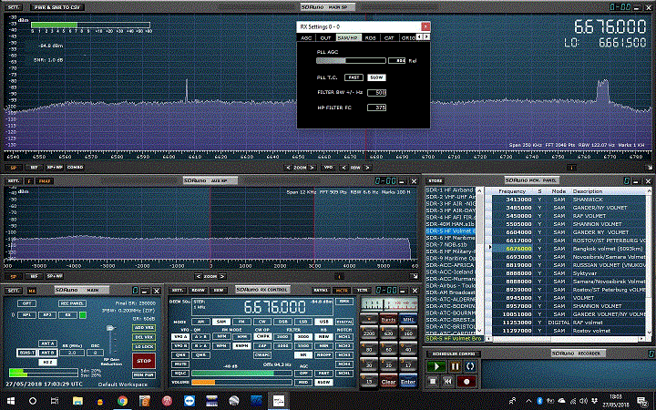

Sadly, not a new problem for me as this has occured occasionally in the past and I have managed to "cure" it by fiddling with the SAM/HP filter settings menu, although quite how I have managed this is rather opaque, but always returning to SLOW mode.
Gain/Gain reduction settings , volume and antenna choice do not seem to be related.
If anyone has any useful suggestion on how to resolve this, I would be most grateful.
This current occurrence is associated with the latest Windows 10 update, which produced a plethora of unwanted effects, some of which I have identified and hopefully sorted out to my satisfaction.

What's actually happening - ie what does it sound like? I notice from your screenshot that your noise level is high and I can't see the level of the incoming signal as it is hidden behind the SAM box. However I think the SNR is very poor, possibly 3dB? I think under those conditions it would be difficult for any SAM system to lock.
EDIT - I've just noticed you have the gain to minimum.

Thanks yet again Andy. I'm pretty sure that in this case you are on the money.
However, somehow or other, it's back to normal again, but I've also had all sorts of issues with the latest teration of Windows 10 (knocking them off one-at-a-time).
