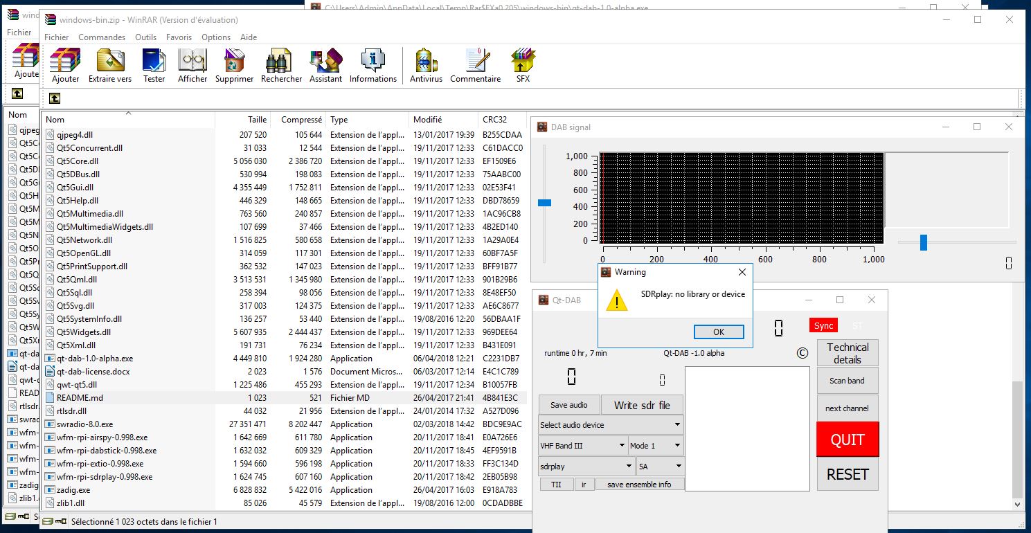

Does Qt-dab software (to listen to DAB stations) work with a RSPduo ?
Attached is a screenshot of the "no library or device" that shows up when selecting 'sdrplay' as a device'.
Thanks.
Thanks.

The following message also shows : "failed to locate API registry entry, error = 0"

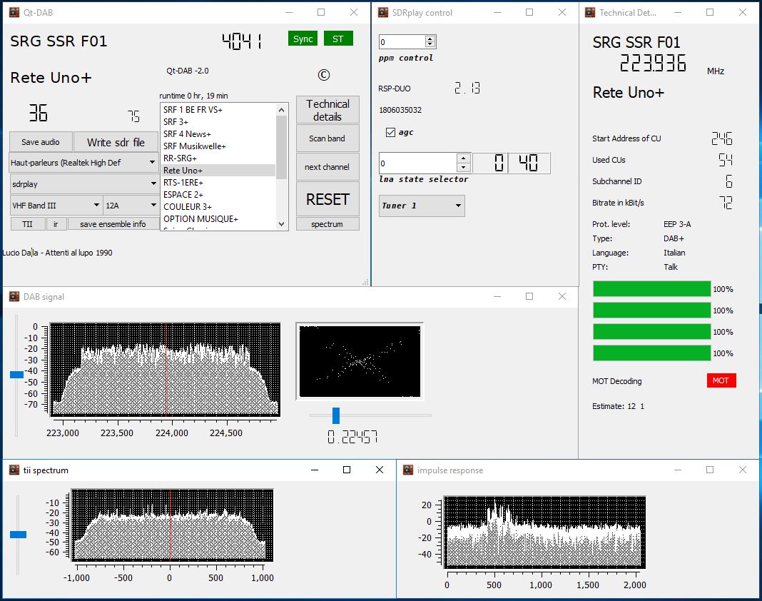

Jan just sent me a new release of Qt-dab 2.0 and ... At last it works !
