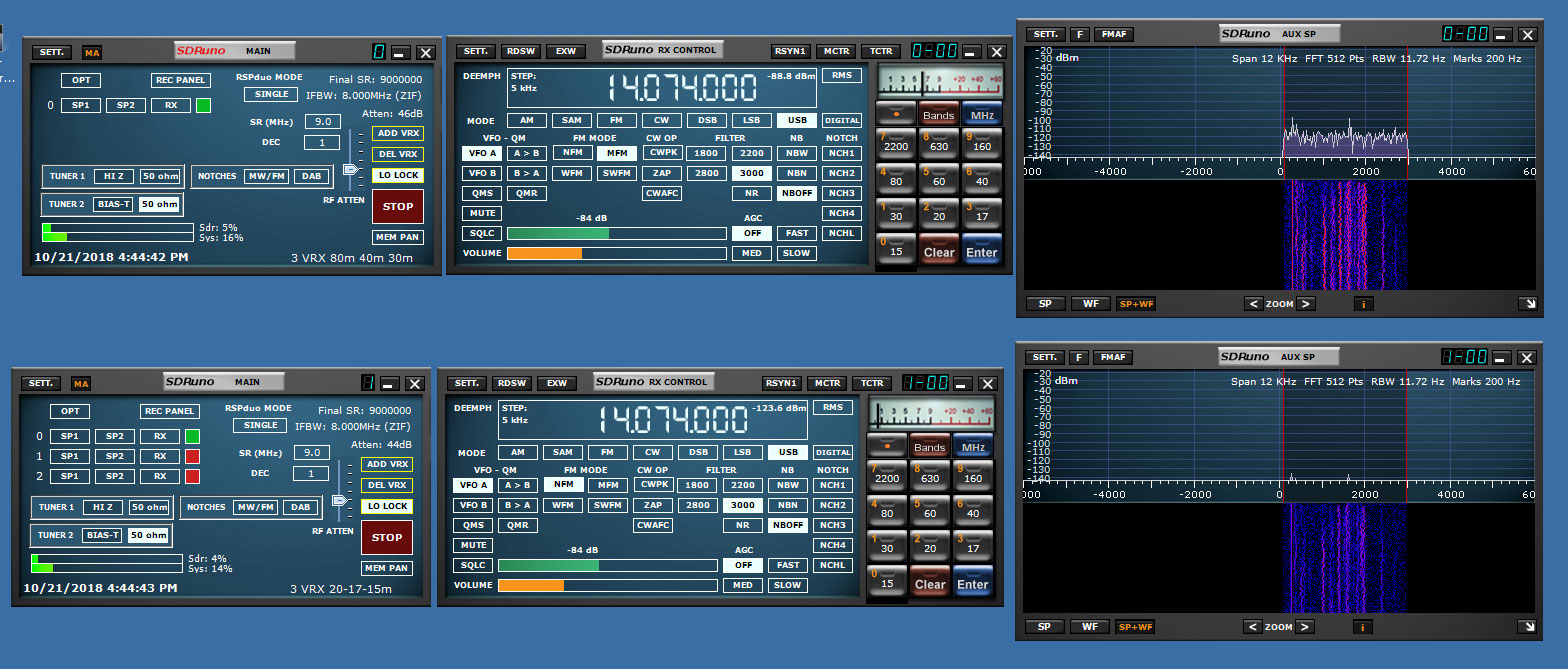

In the meantime, below is a screen shot of two SDRUno instances, 0 and 1. Each is connected to a separate RSPduo, which share a single antenna. The only differences I can see in the way I have them set up is:
-- Instance 0 has one VRX defined. Instance 1 has three VRX's defined, but only one is active.
-- The RF ATTEN slider on both instances is set to three notches up from the bottom. Instance 0's Main window shows Atten: 46 dB, while instance 1's Main window shows Atten: 44 dB. I haven't been able to get the two sliders set in a way to get these numbers to match.
-- The FM mode settings are different, but that shouldn't matter since the active mode is USB.
As noted, instance 0's RX Control window shows -88.8 dBm next to the frequency display. Instance 1 shows -123.6 dBm. Instance 0's waterfall shows visibly stronger signals, and the instance of WSJT-X it's connected to produces more than twice as many FT8 decodes.
Short of doing an SDRUno factory default reset, can you see any settings that would account for the difference in output? As noted, the difference is associated with the SDRUno instances, not with the RSPduos.

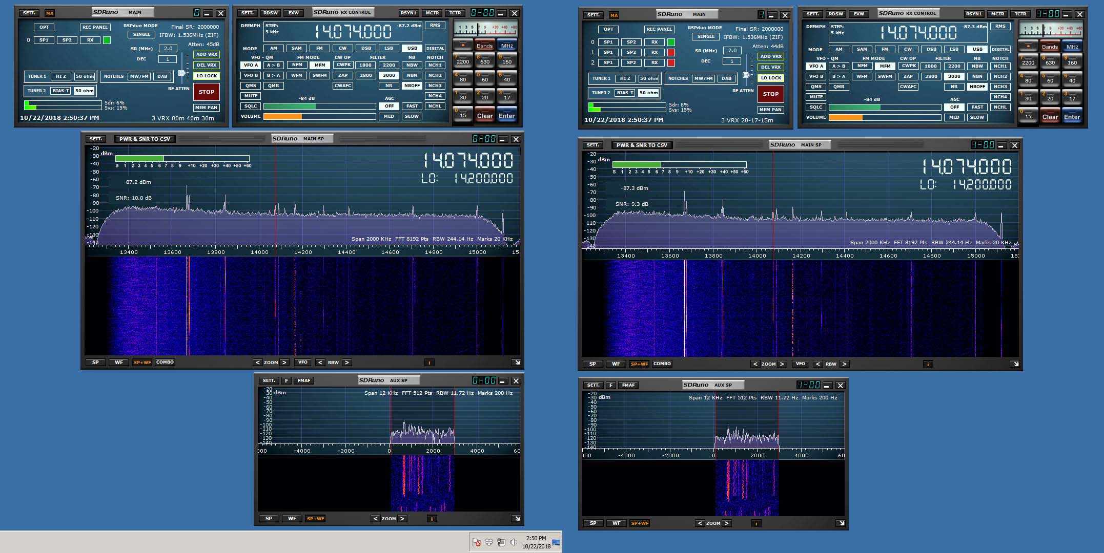

Can you also show the SP1 (Main SP) windows and change the sample rate to 2 MHz in both instances. It will make it easier to see what's going on in the images. Thanks.

Hmm, well, I seem to have my issue basically resolved now, though I'm not sure exactly what the cause was, or what fixed it.
When I changed the sample rate to 2 MHz and clicked to display the SP1 windows, I noticed that the LO was somewhat different in one instance, so I sync'd them up. Now the two instances appeared to be producing very similar results, with nearly identical dBm figures in the frequency window (see screen shot below). So, basically, I was no longer able to replicate the problem. Changing the LO around (even making it the same as the tuned frequency) doesn't replicate the performance degradation I'd seen previously, so I'm baffled as to what made it better).
