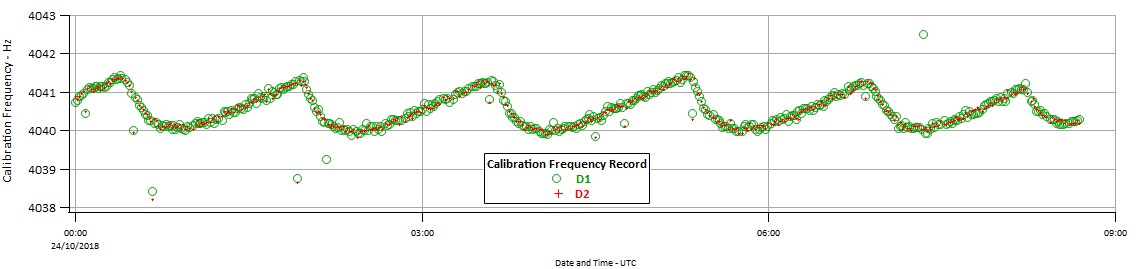

The frequency stability seens to be better than my RSP2-Pro; using a GPS reference calibration the two tuners have settled down to a standard deviation of withing 1.5 Hz in 143 MHz for day periods compared to 3 Hz for the RSP2. The calibration frequencies are output on VACs and recorded every 1 minute. Both tuners match each other, following the small temperature drifts in my receiver room. There are a few spurious points which I have yet to evaluate. Using the reference frequency capability will of course improve things ... but not bad without ;-)

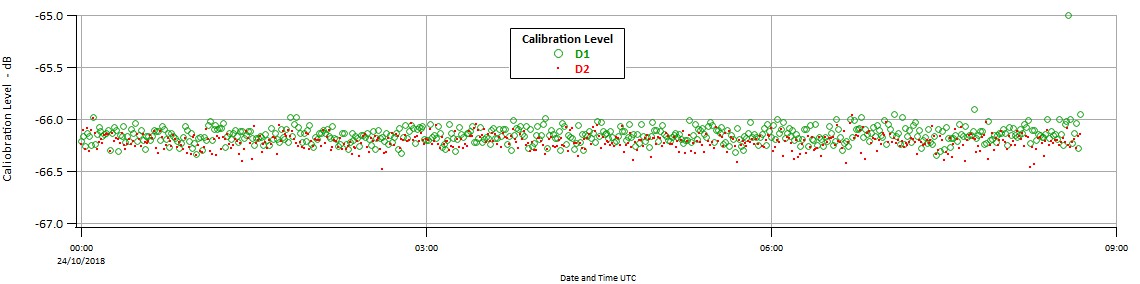

In another post I have spoken of my problems with output level shifts and that has yet to be resolved. However, the calibration signal levels between the two tuners are again well matched and stable. The SNR is around 35 dB and the monitored levels over an 8 hour period is shown below. The standard deviations in these dBm levels for the two tuners is 0.34 and 0.07 dB. Variations seem reasonable for the SNR.
