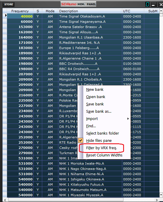

Have you tried using the tracking feature by right clicking the Memory Panel?

Right click the memory panel and then select the item shown in the red box....Paul wrote:Tracking feature Roger?
Off to check the manual forthwith..
Did you by any chance mean the "Find" command - If so, yes, I am familiar with that - what I had in mind was akin to the SDR# panel that pops up with info on the tuned frequency (if the information has been stored)
- Filter.png (66.74 KiB) Viewed 32444 times

Thanks again for bothering to reply Roger
To find that I can still be a complete twit at the age of 80 isn't encouraging...
I have been guilty of "male manual blindness."
Goodness knows how I avoided seeing the filtering optionit when I returned to the manual after your response.
However, to be honest, the find command may be my current best option and has a lot of flecxibility.
Having had an initial "fiddle" with the filtering facility (the instructions are perhaps a little opaque), I cannot see how it impoves over "find."
I will ontinue to "fiddle."

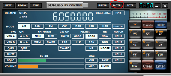

When you filter by VRX Frequency you have to click MCTR in the VRX you are using. You also have to be exactly on frequency (6050.000 kHz. NOT 6050.010 etc.)
