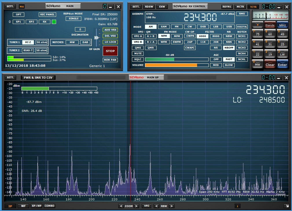

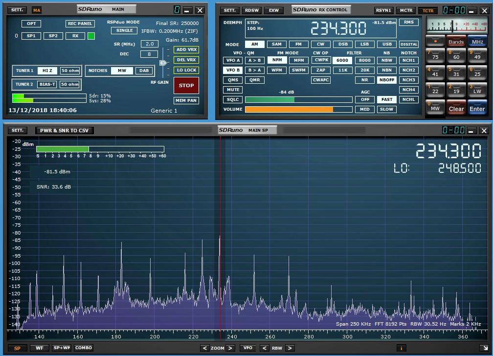

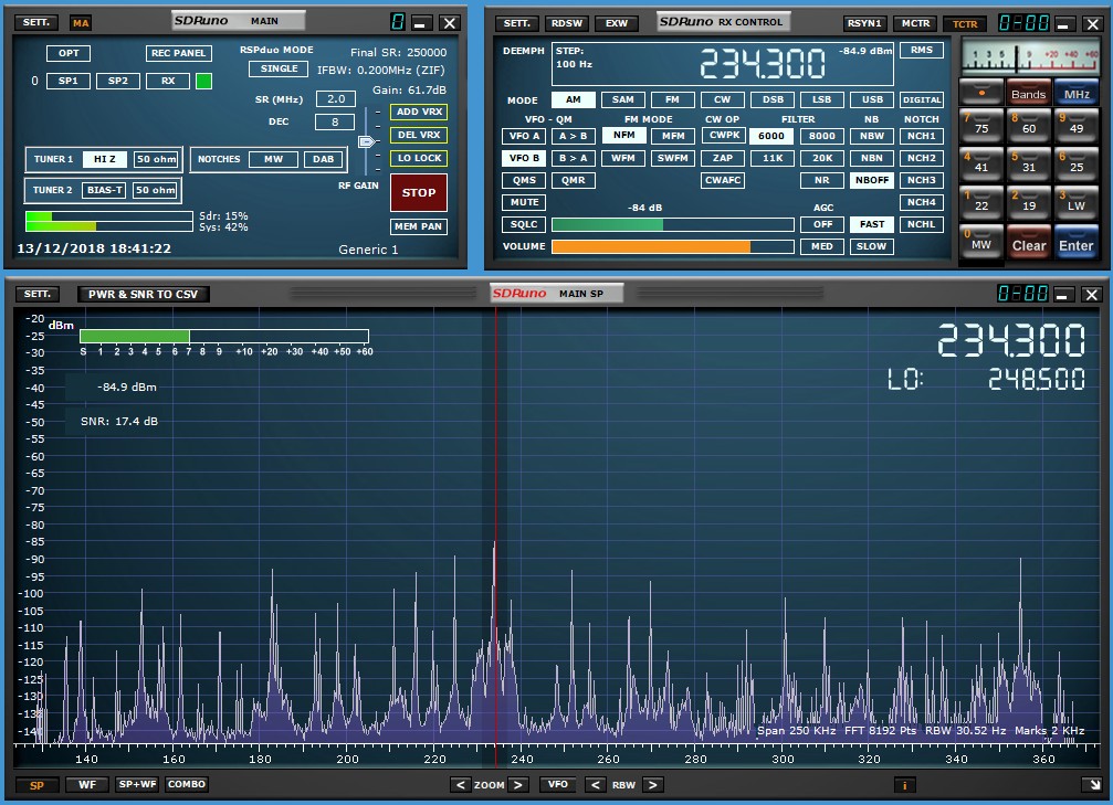

The incoming level of a MW broadcast station between -50 and -40 dBm is perfectly normal and most common, so we must live with it, but RSP class receivers are perfectly capable to cope with these levels while working in LW below the MW band, by using the LOW IF mode, as advised by Tech_Support. I am uploading three PC screens (taken with several MW signals with levels -40 to -50 dBm operating on the MW frequency band immediately above and not shown) as follows:
a) LW reception at ZERO IF with MW NOTCH FILTER IN - no spurious.
b) LW reception at ZERO IF with MW NOTCH FILTER OUT - very many spurious signals and most of them are higher order, not intermodulation.
c) LW reception at LOW IF with MW NOTCH FILTER OUT - no spurious at all!
So for even stronger signals you still have the notch filter in reserve. This is an RSPduo in operation as I do not have the RSP2.

- Figure a - LOW IF WITH NOTCH
- ZERO IF + notch.jpg (200.93 KiB) Viewed 38176 times
- Figure b - ZERO IF NO NOTCH
- ZERO IF no notch.jpg (207.55 KiB) Viewed 38176 times
- Figure c - LOW IF NO NOTCH
- LOW IF no notch.jpg (201.52 KiB) Viewed 38176 times

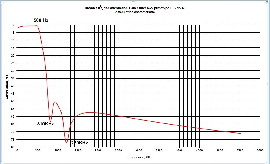

3) I am going to post a lowpass filter design (CAUER C05 15 40) which kills all MW stations and therefore radically eliminates the problem in the LF band once and for all with any kind of receiver, see:
https://www.sdrplay.com/community/viewt ... f=5&t=3943
2) Direct coupling a 105 m long wire antenna (I myself am using a 135 m Beverage) to the P terminal, with N&G terminals to ground is extremely dangerous to the receiver (and to yourself, perhaps?): even a small indirect lightning transient could kill your RSP2 at any moment. Not only that, but you are probably bringing in a lot of noise which significantly reduces your system sensitivity. Please look at:
https://www.sdrplay.com/community/viewt ... f=5&t=3352
Where a lot of info is available, especially in the mid-posts of this long thread.
- MW filter stopband.jpg (168.02 KiB) Viewed 38115 times

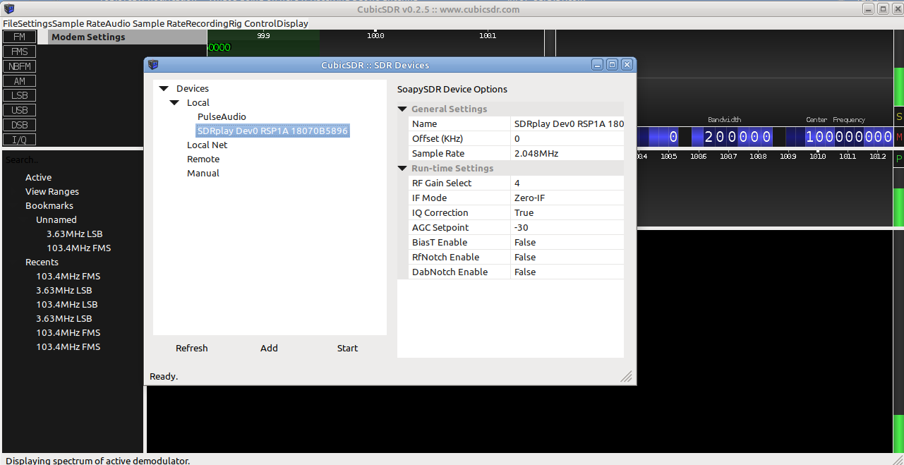

Given that SDRuno is still not available for Mac OS, how can this be replicated in GQRX or CubicSDR?glovisol wrote:go to the top left of the SDRuno main, click SETT. and in IF Mode select LOW-IF and put Decimation to 8 in the Decimation window
Ralf
Re: Long Wave and AM Broadcast interference
In CubicSDR it's no problem, select the IF-mode before you start the device.
Decimate is not needed to select, makes not that much of a difference.
I myself use Zero-IF where possible combined with RfNotch if needed.

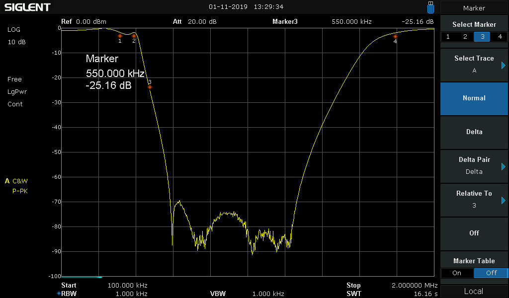

It is pretty easy to build out a band stop filter using the Mini-Kits bare filter circuit board. I built out one for 500 Khz to 1600 Khz for use with my Elad Duo and SDRPlay RSP1A. Please see attached sweep of the filter. A number of AM stations at my location have signal levels of -30 dbm. For specific frequencies, you could use the same board to build out a notch filter. Another option, using the same board, is to build out a low pass filter with a cutoff of 500 Khz.
Regards
Clint
W7KEC
Regards
Clint
W7KEC
- AM Band Stop Filter.jpg (80.02 KiB) Viewed 36921 times
