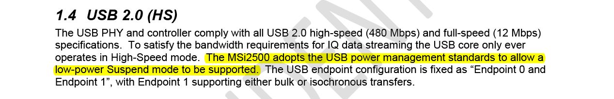

According to Mirics the SDRPlay USB chipset supports suspend mode:
http://www.mirics.com/MSi2500%20Datasheet%20R1P1.pdf
Clint wrote at the outset
I do not see this screen saver problem when running HDSDR and SDRConsole. After the screen times out, I just hit the mouse button and the app comes back.
Not mentioning any names but I can see a prime suspect for this hang.
