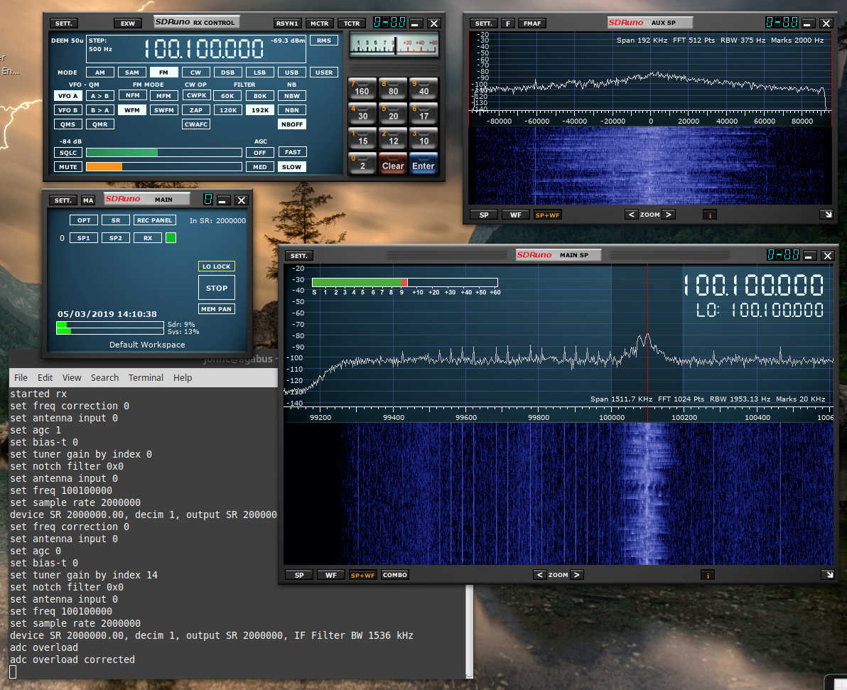

All that remained was to hit Play and tune in to a favourite station!
As the desktop snapshot shows, this came though loud and clear!
A couple of points to note are, that there may be one or two graphical artefacts. For example, the audio device selection box was distorted. The EXTIO version does not seem to quite have all of the facilities that the USB version has. For example, there is no band selection button on the received panel, and no antenna selection. I think antenna selection has to be done when staring RSP_TCP by using the -P parameter.

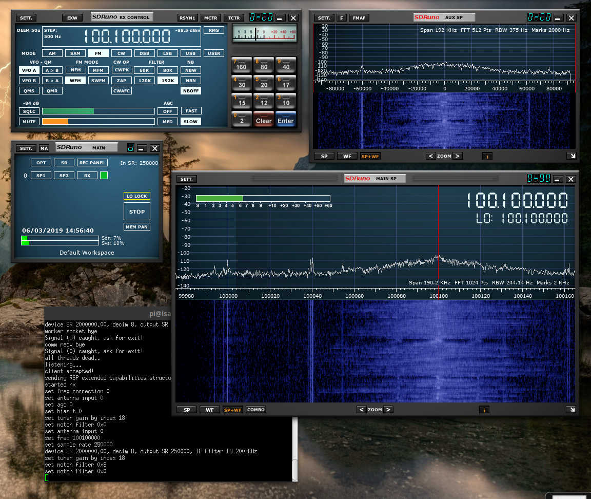

The attachment is pretty much as above but now shows Classical FM being received using the SDRuno EXTIO client running in WINE on Mint 19 and the RSP_TCP server running on the Pi with the RSP connected.
