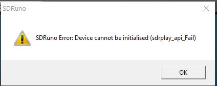

It' is possible to install and run SDRUno 1.22 and SDRUno 1.3 with an RSP2 on the same machine. When I installed v1.3 yesterday, I made it a point to rename the install directory to 'SDRUno 1.3' to allow this scenario. SDRUno 1.22 does not use the service based API, so it can run just fine with or without the API.
However, it appears versions 1.23 and 1.24 of SDRUno are not compatible with the latest API used by version 1.3. I have 1.23 installed also and it would not start. I believe it generated the error that 'No RSP's could be found'.
Correction: this is the error:
As to John's original question about sensitivity, I tried both programs (1.22 and 1.3) by tuning each to a local medium wave broadcaster (about 70km from my location). This was in the afternoon receiving a ground wave signal. The signal levels were stable as well as the SNR. I could detect no significant difference in signal levels between the two programs, other than minor random variation.

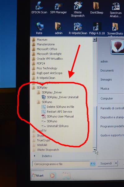

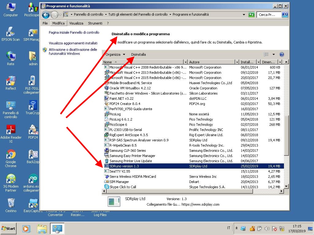

Re: New Version 1.3 disapointing
This is what I mean....
Cheers,
Cheers,
- DEINSTALL 1 .JPG (60.6 KiB) Viewed 36777 times
- DEINSTALL 2.jpg (260.63 KiB) Viewed 36777 times

Thanks for the tips about SDRplay own uninstall tool.
