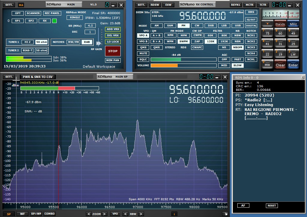

Ver 1.3 works fine in Broacast FM. Here below PIC showing settings. On second PIC signal is so strong the S Meter is pinned to the right!
ScreenHunter 334.jpg (197.19 KiB) Viewed 34937 times
ScreenHunter 333.jpg (202.55 KiB) Viewed 34937 times

glovisol, how does yours shows DAB? I cannot get it to show that..

Re: 1.3 Unable to select WFM and SWFM
Post by g1hbe » Sat Mar 16, 2019 12:50 pm
illlm - the DAB notch filter will only appear if you have the RSP1a or the RSPDuo. Other models do not have the hardware to implement it. My RSP2 only shows notches for MW and FM.
