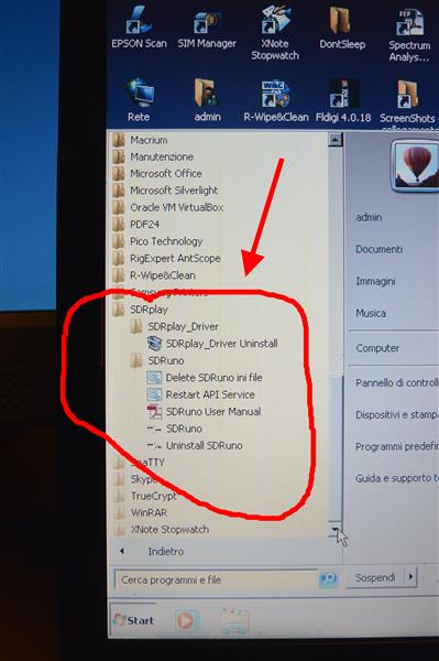

Hi Robert,
Perhaps you should locate the "Restart API service" file and click on it and/or delete the SDRuno INI file when you have difficulties, see pic below....Perhaps you do not have to re-install all with this trick.
- DEINSTALL 1 .JPG (60.6 KiB) Viewed 26183 times

a. Re unplugging and re-plugging the USB cable: Why does it matter which end is unplugged ?
It was mentioned to unplug from the SDRPlay side.
b. I never knew about that listing on the left that shows the Restart api Service.
Will certainly try it.
c. Could you perhaps discuss a little bit re the suggestion to Delete the SDRUno INI file. Why ?
I guess I don't understand what this does.
What does deleting it actually do ?
**Does it have to be re-installed ?

Re: For Mike: Bug In Latest Vers. ?
You can unplug USB any end.
You can close SDRuno, restart api service & delete ini file then restart sdruno afresh, no problem try it
