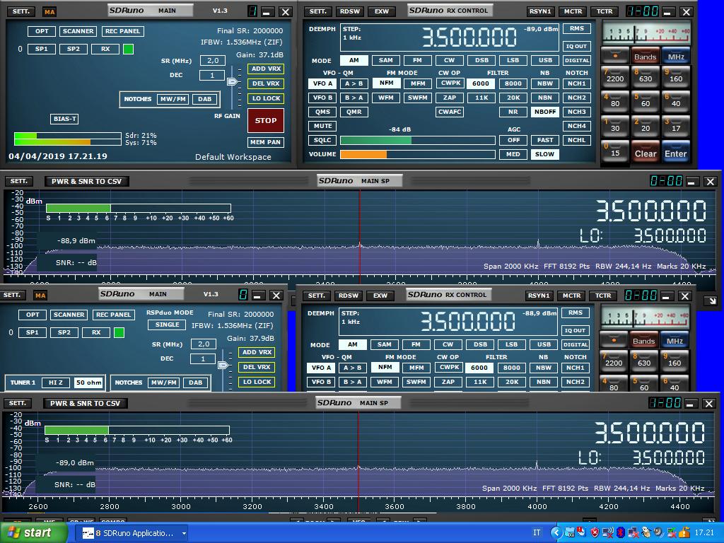

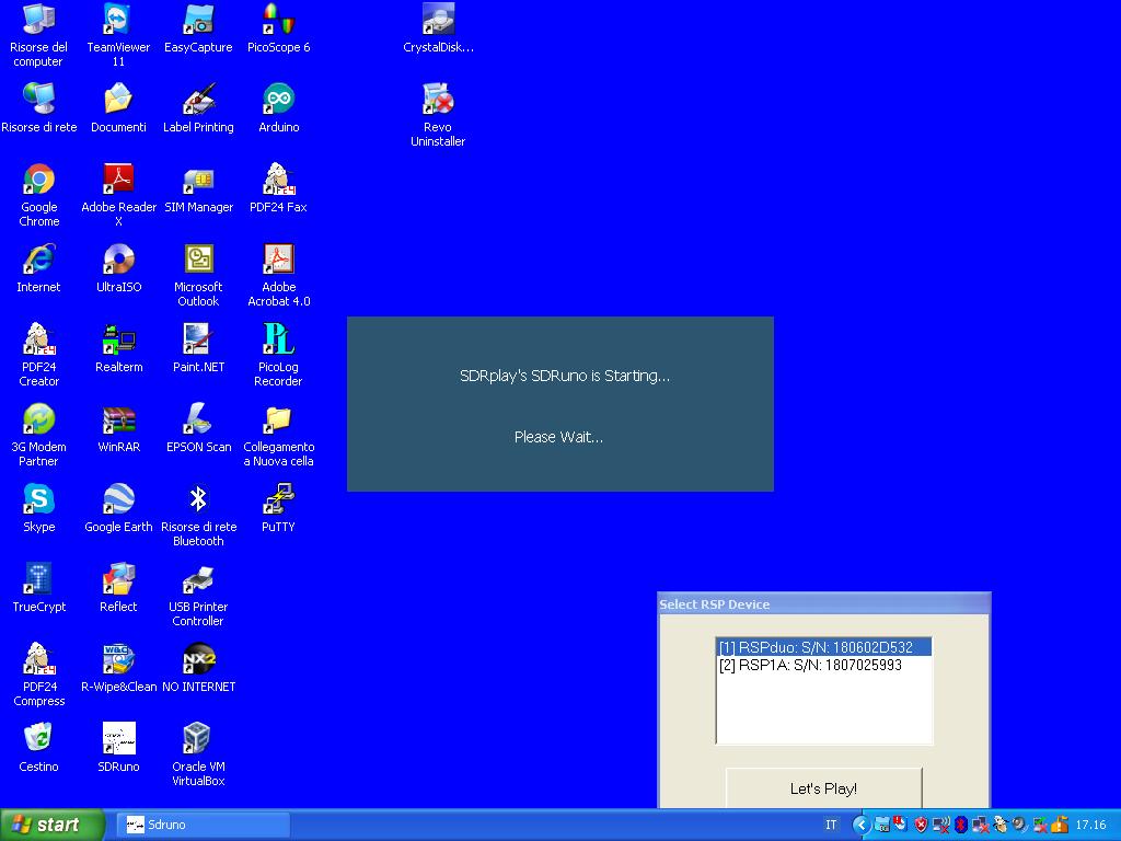

So I quickly installed SDRplay Ver. 1.3 on the XP. Unfortunately I do not have an RSP2, but I have an RSPduo and an RSP-1A. I USB connected one after the other (waiting for each driver to install) and clicked on the SDRplay icon. Instantly the selection window appeared (SCREEN 1). I chose the RSPduo and it immediately opened up and started working. I then clicked the SDRplay icon a second time and the RSP-1A immediately opened up and started working as soon as turned on. So I could verify that both receivers work normally at the same time under Ver.1.3 (SCREEN 2).
